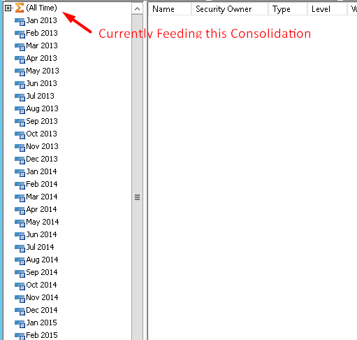

I would like to feed from a consolidated element to leaf level element and am looking for an optimal way to do this.
Here's the scenario....
My rule in the target cube is populating leaf elements with values from a consolidated element in my source cube. Rule and Feeder currently working fine as is, looking to see if there is an optimal way to feed from a consolidated to a leaf element. As the model grows this feeder will become more inefficient I believe and am looking for alternate ideas.
RULE:
['Amount']=N:
DB('rp_SourceReporting',!Account,!Line Item,!Currency,!Entity,!Scenario,!Time | ' CTD,'Amount')
FEEDER:
['Amount']=>
DB('rp_TargetReporting',!Account,!Line Item,!Currency,!Entity,!Scenario,'(All Time)','Amount');
Currently I'm feeding the (All Time) roll up as my leaf elements that are being populated with the consolidated values will be fed.

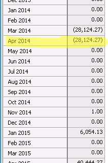

Basically it means "cumulative to date" and each Parent has the preceding Parent + the month as children.
So as an example if you wanted to look at a cumulative balance at December 2016 my Time dimension aggregates in a hierarchy all the values from the beginning of time into this Parent.
Source Cube = Rule pulling from element CTD Apr 2014
Target Cube = Rule populating leaf element Apr 2014
If I feed from leaf elements the result will be unfed since there is a 0 value in Apr 2014 in my source cube.

I don't know what to tell you here, there really aren't any "suggestions" as to how to feed from a C level element to a leaf. You just do it. There aren't any options to choose from. In your case you are aggregating balances from the beginning of time (as you have defined it) and you are passing that aggregated value over to the reporting cube as a total. Now you need to feed it and you did it by feeding from the aggregate. This is the technically correct way to do it. The only options I can think of are to:
