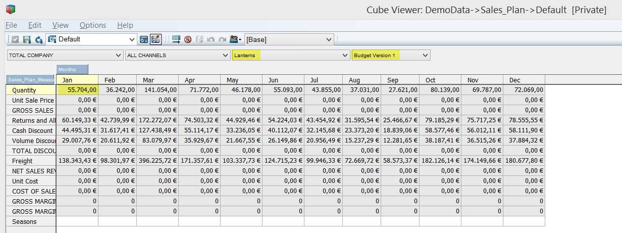

Here is the value 55.704,00 for "Quantity" in "January" for "Lanterns", "Budget Version 1", when I select
store values:
- store values cube.jpg (92.76 KiB) Viewed 56170 times

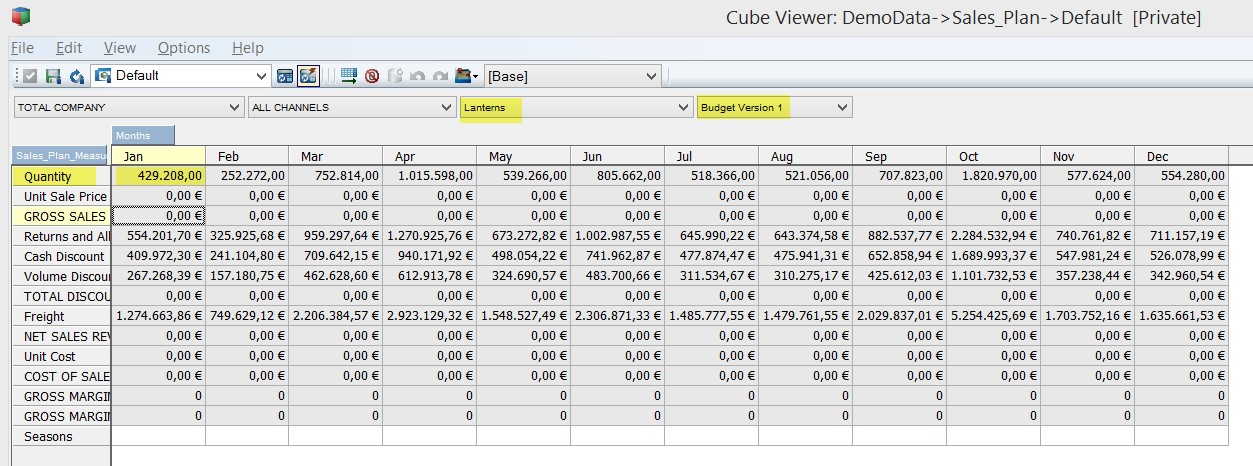

here is the value 429.208,00 for "Quantity" in "January" for "Lanterns", "Budget Version 1", when I select
accumulate values:
- accumulate values cube.jpg (98.5 KiB) Viewed 56170 times

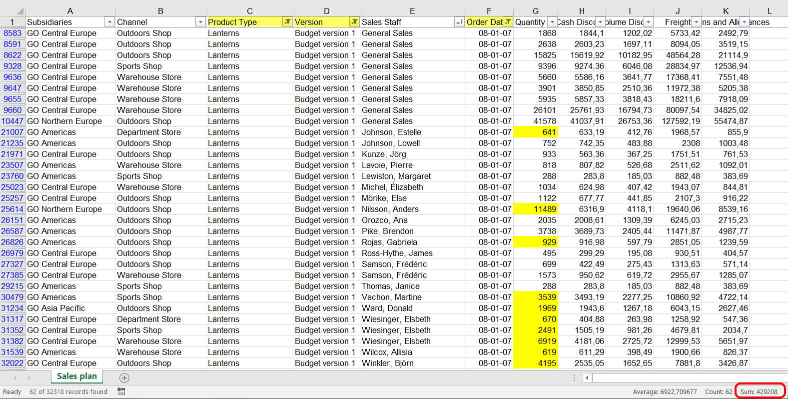

I checked the source excel file and got how the values sum up to 429.208 for
accumulate values:
- accumulate values excel source.jpg (284.52 KiB) Viewed 56170 times
But I cannot get how the values sum up to 55.704 for
store values, I marked these values yellow.

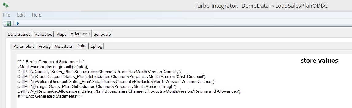

here are the scripts generated by Wizard. Store Values, as you wrote it is CellPutN( ):
- script store values.jpg (42.91 KiB) Viewed 55836 times

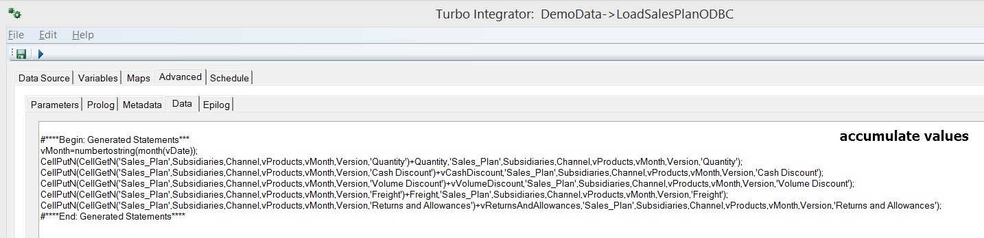

Accumulate Values, as you wrote it is CellPutN( CellGetN( ) ):
- script accumulate values.jpg (66.59 KiB) Viewed 55836 times

Okay, so if you bypass the wizard code of CellPutN and CellGetN, it would be a CellIncrementN function.
