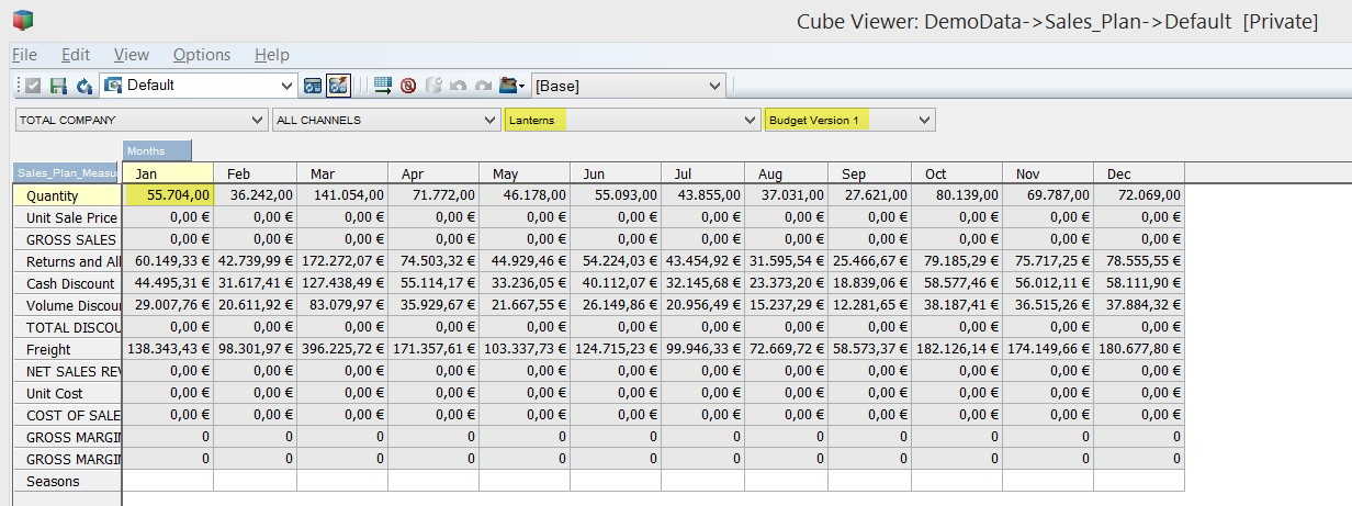

I got the basic concept how store values vs. accumulate values works, but I cannot explain the values from the 6 dimensions cube from the recipe from TM1 Cookbook (Ankit Garg).
Here is the value 55.704,00 for "Quantity" in "January" for "Lanterns", "Budget Version 1", when I select store values:

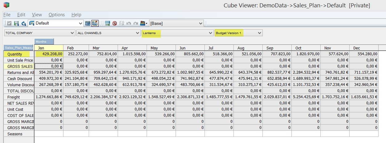

here is the value 429.208,00 for "Quantity" in "January" for "Lanterns", "Budget Version 1", when I select accumulate values:

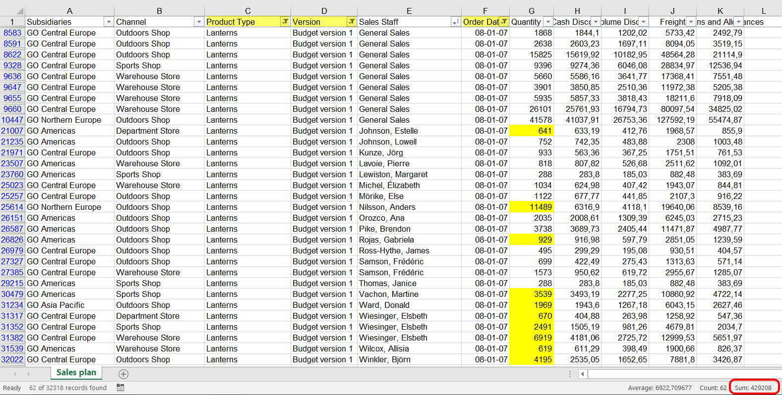

I checked the source excel file and got how the values sum up to 429.208 for accumulate values:
accumulate values excel source.jpg (284.52 KiB) Viewed 56162 times
But I cannot get how the values sum up to 55.704 for store values, I marked these values yellow.
I would appreciate any idea on my example!

After posting the question on forum it seems I found the answer. I just needed to sort the dimensions in "A to Z" order starting from the last one in the cube, then it becomes really obvious which values TM1 takes from this excel file in case of Store Values.

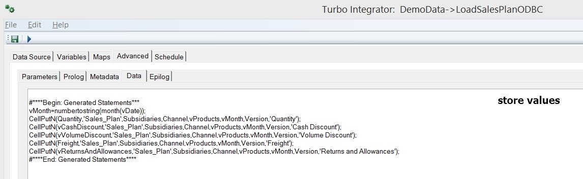

here are the scripts generated by Wizard. Store Values, as you wrote it is CellPutN( ):

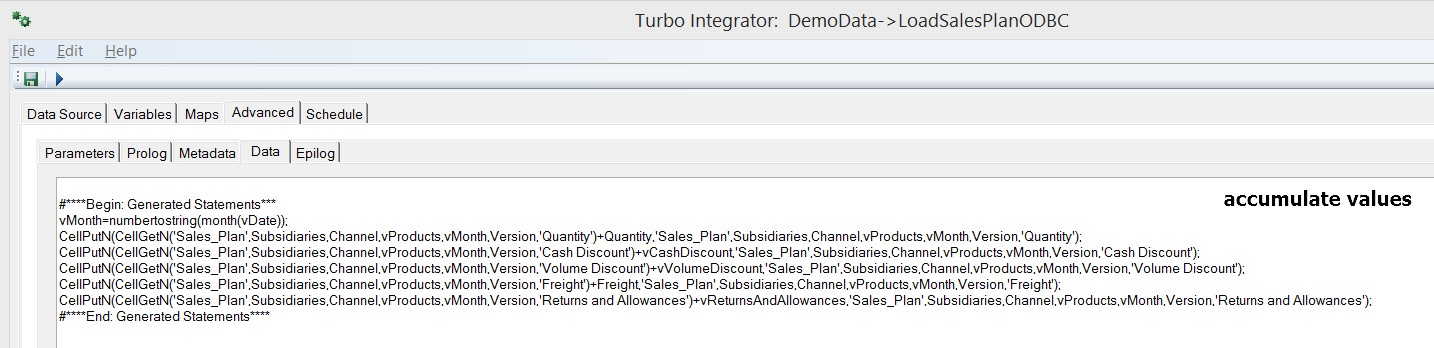

Accumulate Values, as you wrote it is CellPutN( CellGetN( ) ):

My question is actually already solved, thank you and @gtonkin for your help!
Re: Store values VS. Accumulate values
Okay, so if you bypass the wizard code of CellPutN and CellGetN, it would be a CellIncrementN function.
