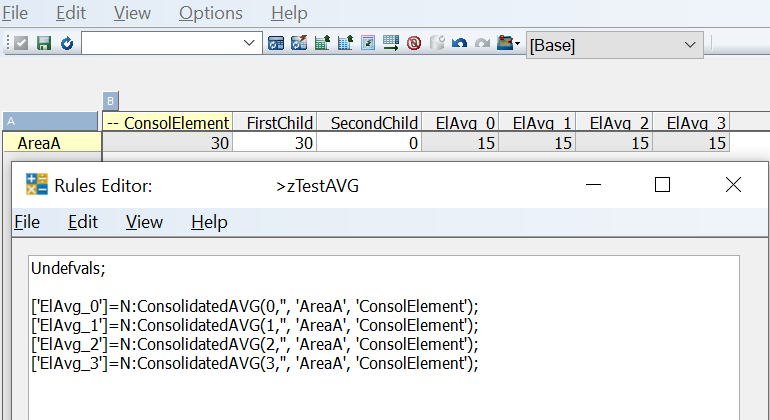

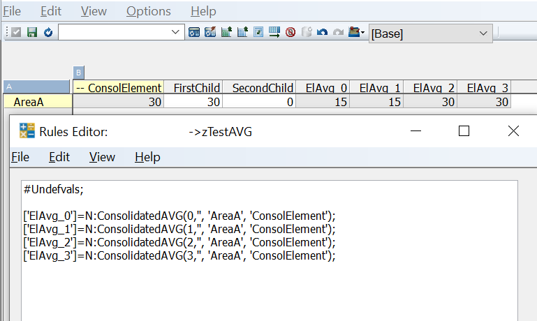

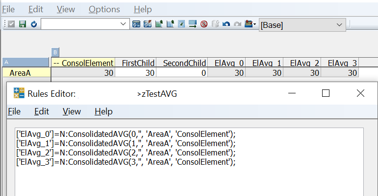

Here are my screen prints:
First with the rule as you have it:
Then with undefvals in the rule:
Then with Undefvals commented out:
regards, Maren
Re: Flag value in consolidatedavg function
Posted: Wed Jul 03, 2019 6:16 pm
by Wim Gielis
First test without undefvals like me.
Posted: Thu Jul 04, 2019 10:30 am
by MarenC
Hi Wim,
That is what I did, if you look at my first screen print in the comment above I first had the rule just as you had it, i.e. without undefvals.
The second and third images then show what happens when I use undefvals
