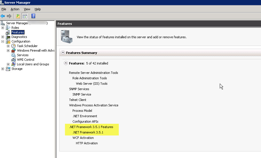

That seems OK; I would however go to Server Manager (right click on Computer in the Start menu and select Manage then go to Features) and just make sure that it hasn't been turned off:
