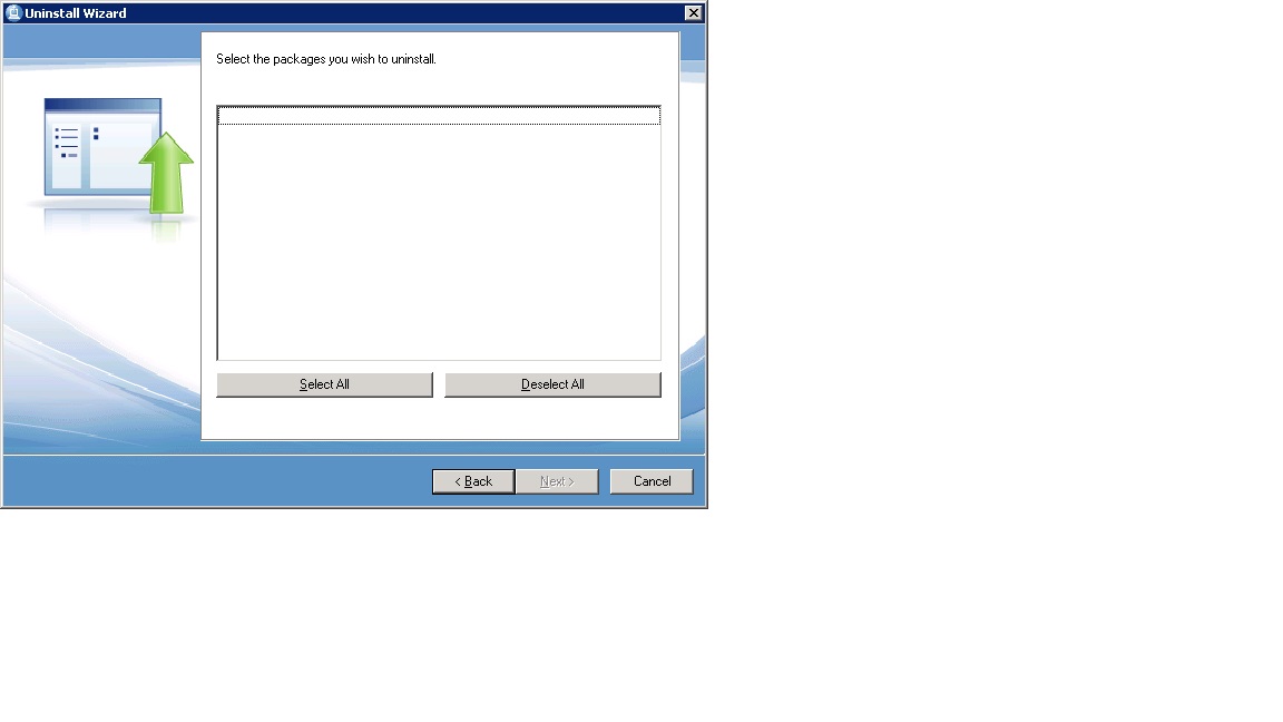

I'm trying to uninstall TM1 v10.2.2 on a test server, but when I run the uninstall wizard the packages list is blank. How do I get past this? Thanks.
uninstall wizard.jpg (61.18 KiB) Viewed 4298 times

Hi, you can always have a try with an independant uninstall tool.

Alternatively, you could just try and re-install 10.2.2 over the existing install and then re-try the un-install. Make sure you also 'run as administrator' for installs\un-installs.
