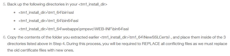

Dear All,
In accordance with the IBM document, the upgrade of the SSL, i can log in to server througth the Achitect, but there is a problem, access to TM1Web, can not get any TM1 Server in the droplist.
TM1 Version : 10.1
OS: Win2003
Web is IIS
Tks for all your help!!!!
TM1 Version : 10.1
OS: Win2003
Web is IIS

Have you added the certs to
1) Tomcat folder
2) Java keystore
3) Windows Keystore
HAve you recycled the Tomcat working directory?

AFAIK, you just need to run the following from the command prompt, as admininistrator, in the SSL folder after stopping services and replacing the certifcates with the new ones.
There is a lot more waffle in the IBM doc but not relevant.
importsslcert.exe -remove
importsslcert.exe -

That's correct, but if you don't do it then you won't be able to connect with Architect either. Yet the original poster claims that the latter is possible and it's only Web that isn't showing the list of servers.gtonkin wrote:AFAIK, you just need to run the following from the command prompt, as admininistrator, in the SSL folder after stopping services and replacing the certifcates with the new ones.There is a lot more waffle in the IBM doc but not relevant.Code: Select all
importsslcert.exe -remove importsslcert.exe
Restarting the Web Publishing Service wouldn't be an entirely bad idea to see whether that rectifies it. I didn't explicitly do it but I rebooted the physical servers as a precaution and because they were overdue for it anyway, which amounted to the same thing. It doesn't cost anything to give it a shot.

I tried a variety of ways, still can not get the server list, very sadddddddddd
