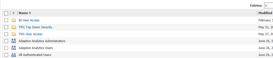

I think you have different groups in different folders with one name. The CAMID in TM1 does contain the folder, but the alias "}TM1_Display_Value" (looks like "Cognos\GroupName" does not. TM1 tries to give one alias to different groups and throws the error.
The group names must be unique if you want to import them in TM1.

Yes we have 2 folders for groups.
But at first few of the group names are same in both the folders,but later we have renamed the groups with unique names.
We renamed the groups once we faced the error while importing the first group.
We are still facing the issue even after having the unique names.
Please find the attachments.
Thank you.
