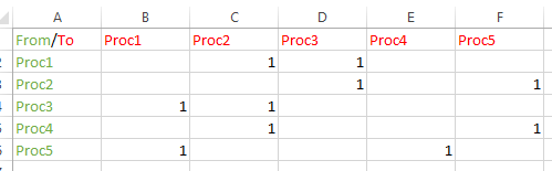

You can prepare a adjacence matrix in Excel, open this Excel file with the yED editor and point it to the matrix. It will build a .graphml-file from that. You have now inside the editor a feature called neighborhood, looks like this: yED neighborhood example. If you click on an item, the neighborhood vie shows the precessors and the successors.
Just make a matrix:
Example Matrix
Example Matrix

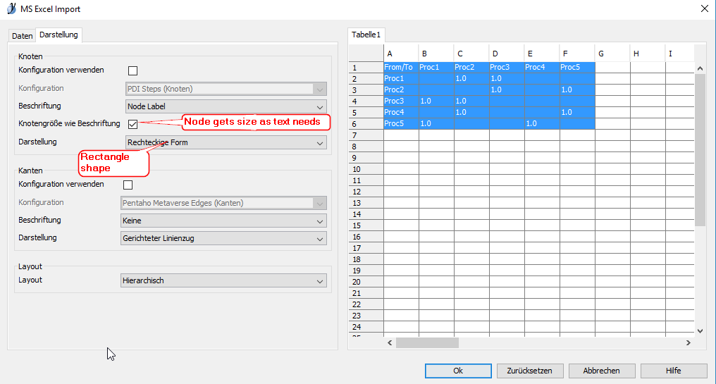

then open it with the yED editor and import it as a adjacence matrix
and determine the rough style of the graph
style
style

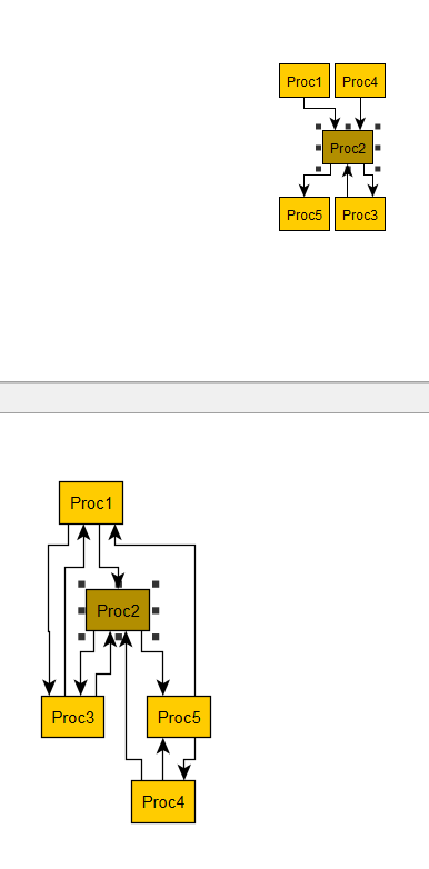

Here it comes:
Graph below neighbourhood above
(graph below neighbourhood above: In the graph "proc2" was clicked, which leads to the extracted view above)
Obviously it's not a kind of automatic analysis of metadata, but as I document my own framework continously, it helps tremendous to indicate, which Processes are dependent from whose others. Before I change them and create side effects for later... 8-)
