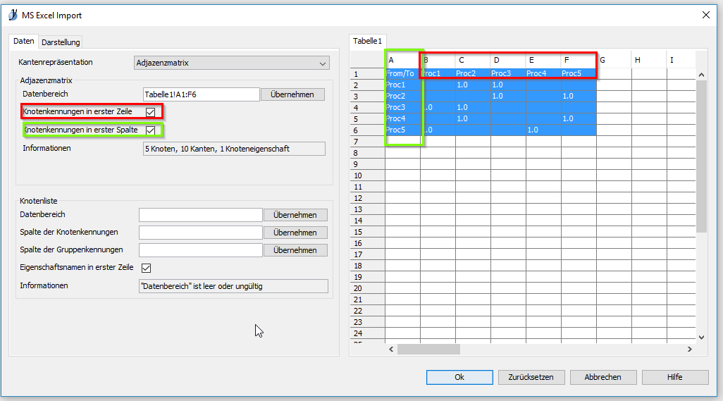

The topic is a little older, but just to share another possible solution to this: I solved it for my own purposes using yED: https://www.yworks.com/products/yed
You can prepare a adjacence matrix in Excel, open this Excel file with the yED editor and point it to the matrix. It will build a .graphml-file from that. You have now inside the editor a feature called neighborhood, looks like this: yED neighborhood example. If you click on an item, the neighborhood vie shows the precessors and the successors.
Just make a matrix:
Example Matrix
Example Matrix
then open it with the yED editor and import it as a adjacence matrix
and determine the rough style of the graph
style
style
Result? Watch the next post, as I could only pots max. 3 images per post, as it seems... ;-)
