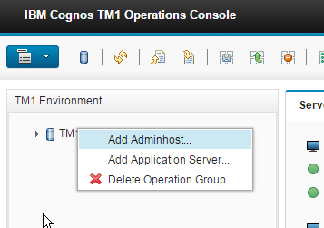

I am running into an issue where I cannot have 2 tabs open in chrome where both point to separate admin hosts when viewing stats within operation console.
We also have the same issue in perspectives where we cannot see more than 1 tm1 server from separate admin hosts. If we do we encounter the following error as well:
DPR-ERR-2107 - The User Capabilities Cache cookie cannot be decoded.
To fix the issue we have clear out history within Chrome when wanting to view another host operation console every time. I thought I stumbled across something the other day

Hi, I haven't encountered your problem when using ops console but you mean you have this issue when adding another admin host in this way?
2015-09-25 09_40_16-TM1 Operations Console.png (12.05 KiB) Viewed 2513 times
