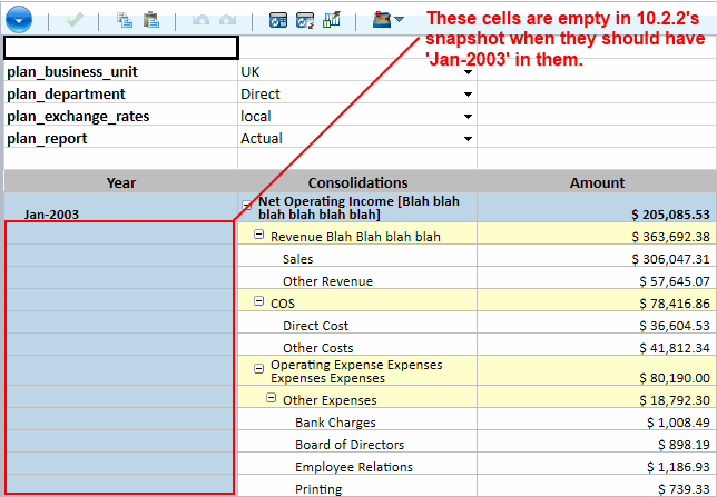

Not long after we upgraded to 10.2.2 FP3, a user told us snapshot to Excel on TM1Web is not really working. For columns where values are generated by TM1RPTROW formula, if there is a bunch of rows that have the same values (eg. column 1 may have the same employee names from row 5 to 10 because row 5 to 10 are showing different types of data about the same employee), usually only the 1st one will be shown and the rest will be hidden by setting the font color and background color the same for the cell. In older versions when you snapshot to Excel these 'hidden' values are still in the cells, they are just hidden cosmetically. In 10.2.2 FP3 the values are just not in the cells at all. They all became empty cells. This basically makes the snapshot feature useless. Combine that with the PDF issue, the entire export feature is broken for us. (Users cannot use slice because they can only access TM1 through TM1Web.) This becomes a serious problem as our users use the export feature a lot.
Here is where "IBM's Support" in the subject of this post comes in. I reported this issue to IBM and I spent more than a month trying to convince them this is actually a defect. The support rep I talked to does not seem to think this is an issue. I can reproduce the issue and showed him and he still does not seem convinced. Last week FP4 is released and I saw that the PDF issue is fixed. I gave it a try on our test server and it indeed fixed the PDF issue. The problem is it introduced a new formatting issue that messed up the formatting for most of our templates. I cannot install FP4 on our production servers as is. I reported the issue to IBM and they confirmed it as a defect. I asked for a hot fix asap and they agreed but the wait time is 6-8 weeks. Last time I asked for a hot fix they also promised 6-8 weeks but no one contacted me after 8 weeks. It seems like at this point there is nothing much I can do. (FP4 did not fix the snapshot issue.)
On the other hand, there is no progress on the snapshot issue. There is no update from the IBM support rep at all. I am left hanging with a broken export feature on TM1Web. I tried to contact our organization's IBM account manager and explained the situation and asked if there is any way he can help. It seems that he has no interest in helping at all. I did not even get a reply.

I can tolerate 6-8 weeks if they do keep their promise. I only asked for a hot fix once couple of years back. By the end of 8 weeks I did not hear from anyone about it. Obviously I would like to see bugs fixed asap, especially considering export on TM1Web is pretty much broken right now. I do understand fixing bugs takes time and as long as they keep their promise and send me a fix on time, I am ok with that. I am simply dreading that after 8 weeks I would not hear from anyone at all.
What makes me getting so impatient is the fact that snapshot to Excel is broken. I can live with PDF export not working and wait patiently for a fix as long as snapshot works. When I found out snapshot also broke it changes everything.

Alan Kirk wrote: I'm disappointed as anything that 10.2.2 Web is still a bugfest though. We can't stay on unsupported 9.5.2 (I don't care, others do) for next year's budget and if something as basic as slicing to Excel is borked then we can't go to 10.2.2 Web either. Which is a pity because 10.2.2 web actually renders websheets properly instead of as randomised cr@p (action buttons, links, column widths, etc), and doesn't leave dozens of orphaned Excel sessions scattered all over the place as 9.5.2 Web often does. So while my Apache skills aren't advanced yet, I'd rather have had that than another round of "guess what this will look like when it's uploaded, now go kill off those 20 Excel sessions before anyone starts work".
But if 9.5.2 web is not an option, and 10.2.2 web isn't an option, that only leaves 10.1. A version that I probably have less experience with than any since the 8.3/8.4 series, sigh. Of course, I figured that 10.1 wasn't important as 10.2.2 set the new direction. So much for that. :roll:
I was going to say slice *seems* to work fine in 10.2.2 but I decided to do a test before I open my mouth. It turns out slice has the same issue as snapshot, although I can only reproduce it with my model, but not on the planning sample that comes with TM1. Our users cannot use slice so it is not a big deal for us. Here is a sample template I created from planning sample:
In the cells I highlighted, when you do a snapshot in 9.5/10.1, these cells will have 'Jan-2003' as values. But you cannot see them because TM1Web hides them by setting the font color and background color the same. Change the colors and they will show up. In 10.2.2, those cells are just empty. I thought this only happens for snapshot and I can see reproduce it with a slice on our production instance. (But not with planning sample. I do not know why.) This drives me insane because our power users download snapshots and put the data through pivot table.
The guy I talked to from IBM still thinks this may be "by design". :x

nanobaka wrote:In the cells I highlighted, when you do a snapshot in 9.5/10.1, these cells will have 'Jan-2003' as values. But you cannot see them because TM1Web hides them by setting the font color and background color the same. Change the colors and they will show up. In 10.2.2, those cells are just empty. I thought this only happens for snapshot and I can see reproduce it with a slice on our production instance. (But not with planning sample. I do not know why.) This drives me insane because our power users download snapshots and put the data through pivot table.
He may be right. The reason you don't see it in Planning Sample is because none of the example reports having an active form with multiple row dimensions (which is where they hide the duplicate elements by changing the cell background and font color. Once you create one like that in Planning Sample you'll get the same result, empty cells. If the issue you are facing is because users want to dump the report into Excel and do a pivot table perhaps you could create a report that isn't based on an active form so they can dump that out. Zero suppression should help make that report not so big. Maybe not the best answer but I doubt you're going to get a bug fix on this because it may well not be a bug in their definition. Maybe an enhancement request instead of a bug report.

tomok wrote: He may be right. The reason you don't see it in Planning Sample is because none of the example reports having an active form with multiple row dimensions (which is where they hide the duplicate elements by changing the cell background and font color. Once you create one like that in Planning Sample you'll get the same result, empty cells. If the issue you are facing is because users want to dump the report into Excel and do a pivot table perhaps you could create a report that isn't based on an active form so they can dump that out. Zero suppression should help make that report not so big. Maybe not the best answer but I doubt you're going to get a bug fix on this because it may well not be a bug in their definition. Maybe an enhancement request instead of a bug report.
The snapshot issue can be reproduced reliably in both planning sample and our own instance. It is only Slice to Excel that I cannot reproduce in planning sample. In any case, the problem is this is *not* the old behavior. From 9.5 all the way up to 10.1 those duplicate elements are only hidden but values are still in the cells. They basically changed the old behavior that I have expected to something else. I hope they are not telling me "this is a feature, not a bug" or "the old behavior is really a defect and we decided to fix it after all these years."
Creating a separate report as data dump is not a practical option. A lot of our reports are created fully utilizing the flexibility offered by active form. It would be difficult to not possible to recreate them in say, a cube view.

nanobaka wrote:From 9.5 all the way up to 10.1 those duplicate elements are only hidden but values are still in the cells. They basically changed the old behavior that I have expected to something else. I hope they are not telling me "this is a feature, not a bug" or "the old behavior is really a defect and we decided to fix it after all these years."
I first looked at this and have to admit I was on the side of IBM with the specific issue in question as I feel that TM1 Web 10.2 is an entirely different beast to 10.1 (and prior) and in my opinion a better one. With the case of snapshots now showing exactly what was rendered in the web as opposed to what was in an excel sheet in the background (which most users should never have had to interact with) I would consider a good thing - they get exactly what they see...
I was about to recommend that you could use conditional formatting on the tm1rptrow which as of 10.2 does in fact allow you to show the repeated elements in an active form; this shows up in excel and the web - so logically it would snapshot out the values... it does NOT (I just tested) - as such I would consider that something that you perhaps could get accepted as a BUG.
