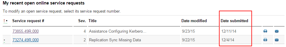

With a few exceptions, I've found everyone at support to be competent and pleasant, but the result has been far from meeting my expectations. This screenshot should illustrate why. I guess at least they have recent "modified" dates, right? Right?
Granted, the first one I graded Sev4, but the issue ended up being so bad/unfixable (10.2.2 doesn't support NTLM, SOX requires integrated login, immovable object meet irresistable force) that I just shut down TM1 Web entirely and forced everyone to use Remote Desktop. TM1 Web has always been a pain for me to administer (what with getting websheets to look right) so maybe IBM did me a favor. I also found a few users who really just needed a couple of static reports, so I wrote a script to dump the data to HTML every hour and deleted their TM1 accounts entirely-- probably not the direction IBM would like.
On the second one, I finally was able to get someone on the dev team on the phone last week, so if FP4 doesn't fix the issue (there's a related PMR, fingers crossed) I'm optimistic he's on it.
Matt
Matt

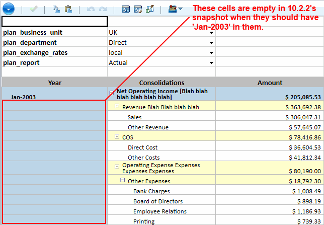

I was going to say slice *seems* to work fine in 10.2.2 but I decided to do a test before I open my mouth. It turns out slice has the same issue as snapshot, although I can only reproduce it with my model, but not on the planning sample that comes with TM1. Our users cannot use slice so it is not a big deal for us. Here is a sample template I created from planning sample:Alan Kirk wrote: I'm disappointed as anything that 10.2.2 Web is still a bugfest though. We can't stay on unsupported 9.5.2 (I don't care, others do) for next year's budget and if something as basic as slicing to Excel is borked then we can't go to 10.2.2 Web either. Which is a pity because 10.2.2 web actually renders websheets properly instead of as randomised cr@p (action buttons, links, column widths, etc), and doesn't leave dozens of orphaned Excel sessions scattered all over the place as 9.5.2 Web often does. So while my Apache skills aren't advanced yet, I'd rather have had that than another round of "guess what this will look like when it's uploaded, now go kill off those 20 Excel sessions before anyone starts work".
But if 9.5.2 web is not an option, and 10.2.2 web isn't an option, that only leaves 10.1. A version that I probably have less experience with than any since the 8.3/8.4 series, sigh. Of course, I figured that 10.1 wasn't important as 10.2.2 set the new direction. So much for that.
In the cells I highlighted, when you do a snapshot in 9.5/10.1, these cells will have 'Jan-2003' as values. But you cannot see them because TM1Web hides them by setting the font color and background color the same. Change the colors and they will show up. In 10.2.2, those cells are just empty. I thought this only happens for snapshot and I can see reproduce it with a slice on our production instance. (But not with planning sample. I do not know why.) This drives me insane because our power users download snapshots and put the data through pivot table.
The guy I talked to from IBM still thinks this may be "by design".
There are a lot of things I like about 10.2.2's TM1Web. Like you said, I do not need to go in and kill those orphaned Excel processes anymore. It also supports Google Chrome now which our Mac users are happy about. (They wish it will support Safari.) But these bugs really should be fixed by now.

He may be right. The reason you don't see it in Planning Sample is because none of the example reports having an active form with multiple row dimensions (which is where they hide the duplicate elements by changing the cell background and font color. Once you create one like that in Planning Sample you'll get the same result, empty cells. If the issue you are facing is because users want to dump the report into Excel and do a pivot table perhaps you could create a report that isn't based on an active form so they can dump that out. Zero suppression should help make that report not so big. Maybe not the best answer but I doubt you're going to get a bug fix on this because it may well not be a bug in their definition. Maybe an enhancement request instead of a bug report.nanobaka wrote:In the cells I highlighted, when you do a snapshot in 9.5/10.1, these cells will have 'Jan-2003' as values. But you cannot see them because TM1Web hides them by setting the font color and background color the same. Change the colors and they will show up. In 10.2.2, those cells are just empty. I thought this only happens for snapshot and I can see reproduce it with a slice on our production instance. (But not with planning sample. I do not know why.) This drives me insane because our power users download snapshots and put the data through pivot table.
The guy I talked to from IBM still thinks this may be "by design".![]()

The snapshot issue can be reproduced reliably in both planning sample and our own instance. It is only Slice to Excel that I cannot reproduce in planning sample. In any case, the problem is this is *not* the old behavior. From 9.5 all the way up to 10.1 those duplicate elements are only hidden but values are still in the cells. They basically changed the old behavior that I have expected to something else. I hope they are not telling me "this is a feature, not a bug" or "the old behavior is really a defect and we decided to fix it after all these years."tomok wrote: He may be right. The reason you don't see it in Planning Sample is because none of the example reports having an active form with multiple row dimensions (which is where they hide the duplicate elements by changing the cell background and font color. Once you create one like that in Planning Sample you'll get the same result, empty cells. If the issue you are facing is because users want to dump the report into Excel and do a pivot table perhaps you could create a report that isn't based on an active form so they can dump that out. Zero suppression should help make that report not so big. Maybe not the best answer but I doubt you're going to get a bug fix on this because it may well not be a bug in their definition. Maybe an enhancement request instead of a bug report.
Creating a separate report as data dump is not a practical option. A lot of our reports are created fully utilizing the flexibility offered by active form. It would be difficult to not possible to recreate them in say, a cube view.

I first looked at this and have to admit I was on the side of IBM with the specific issue in question as I feel that TM1 Web 10.2 is an entirely different beast to 10.1 (and prior) and in my opinion a better one. With the case of snapshots now showing exactly what was rendered in the web as opposed to what was in an excel sheet in the background (which most users should never have had to interact with) I would consider a good thing - they get exactly what they see...nanobaka wrote:From 9.5 all the way up to 10.1 those duplicate elements are only hidden but values are still in the cells. They basically changed the old behavior that I have expected to something else. I hope they are not telling me "this is a feature, not a bug" or "the old behavior is really a defect and we decided to fix it after all these years."
I was about to recommend that you could use conditional formatting on the tm1rptrow which as of 10.2 does in fact allow you to show the repeated elements in an active form; this shows up in excel and the web - so logically it would snapshot out the values... it does NOT (I just tested) - as such I would consider that something that you perhaps could get accepted as a BUG.
But that being said I don't interact with IBM support much and can't speak for what they will or will not consider a bug.
