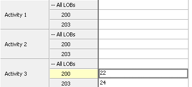

i am experimenting a business scenario and have created a few dimensions and a cube to test the security. I want to hide a particular element from the user. So I went to Dimension > Element Level Security and set the access rights to NONE for element & group combination. But when I access the cube using the test user which is part of the group I have set the access to NONE, I can still see and edit the values for that particular element. Am I doing something incorrect? Or maybe missing something?

- cube view
- activity-cube-values-test-user.png (2.59 KiB) Viewed 7352 times

Hello
You don't have CellSecurity implemented ?
Can you show us a screenshot of the box when you do "Who am I" on the TM1 server name in Perspectives or Architect ?

Can you post screen which shows,
I could be wrong, however my suspect is that, Cognosuser5 is also mapped to "EveryOne" group; which must have higher permission.
- The groups Cognosuser5 belongs to?
- Those groups' rights on the dimension in questions?

Hi Sachin,
Thanks for pointing me in the right direction. It was not the 'Everyone' group but another group that was causing the grief. Thanks.
