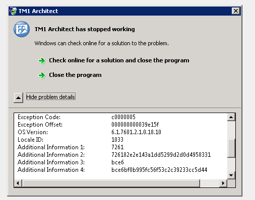

Things are working fine. But except Dimension and subset editor hangs with white screen and popups with close options as below attachments.
So required your help in solving the same. Please read the below problem more in detail.

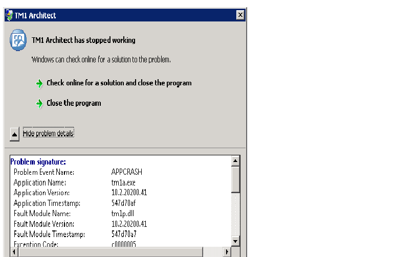

1. When you edit the dimension editor by click on the dimension name in Architect. And when you use Windows+up arrow or just up arrow or down arrow. Immediately the architect goes in to White screen. When ever you press the mouse then it shows the close window popup as shown in attachments.
2. same problem repeats with subset editor.Click on the subset and enter opens the new subset editor.But when you use shortcuts like Windows+up arrow or just up arrow or down arrow Immediately the architect goes in to White screen. When ever you press the mouse then it shows the close window popup as shown in attachments.

- Tm1 10.2.2.png (17.7 KiB) Viewed 7083 times
- subset editor crashes
- image002 (1).png (13.98 KiB) Viewed 7083 times
