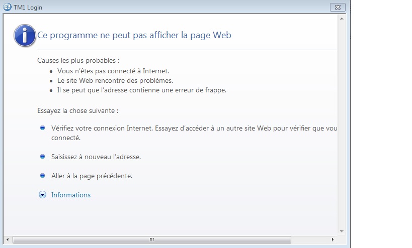

For my preivous client, I had to use IBM Cognos Express and then my current client is using IBM Cognos TM1 10.2. I have install the latest version with the latest pack released in oct 2014
However when I open architect (IBM Cognos TM1 10.2) and I go to client/groups and then add client, I have this pop up windows which tell me error 404
Even if it is French it is mainly say that the server is not avalaible
I have try to install the same 10.2 version on a serveur and I have no message.
Before redoing all my PC does anyone have a suggestion ?

Are you using CAM? If so, check your CAM server settings.
If not, either edit your tm1p.ini file to disable CAM or just delete the file. Architect should be able to recreate it no problems at all.

Thanks you ! Save me a lot of time
