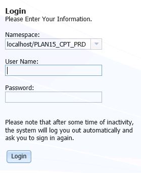

I am requested to select a Namespace and to input user name and password. Namespace are all TM1-servers running on the specified admin host.

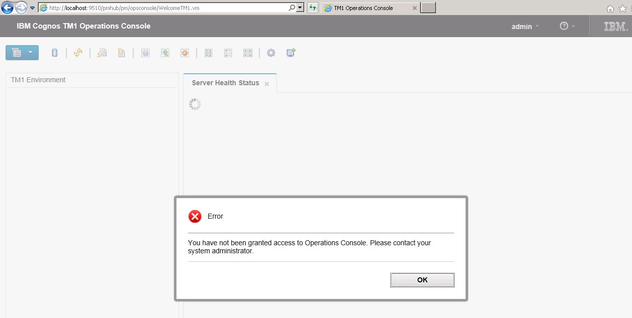

If I put in my credentials (admin user) I get the error message:
"You have not been granted Access to Operations Console. Please contact your System Administrator."

I am only asked for Namespace, User Name and Password see attached screenshot.
I have created a Group "Monitor" and assigned my user to it but it still doesn't work, same message as above.

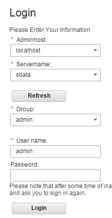

I have no problem connecting to the Operations Console (TM1 10.2.0) but not able to connect to Application server SDATA. I use these parameters in attachment, changed port to 9510 - no success. Can anyone help?
App server parameters
Login
Login
Re: Cannot access the Operations Console
member wrote:Hello,
This will be your SSL settings again; quickest way to check would be temporarily disabling the SSL requirement on pmpsvc then checking this again. If it works you then reinstate SSL and set up all the required certs.
