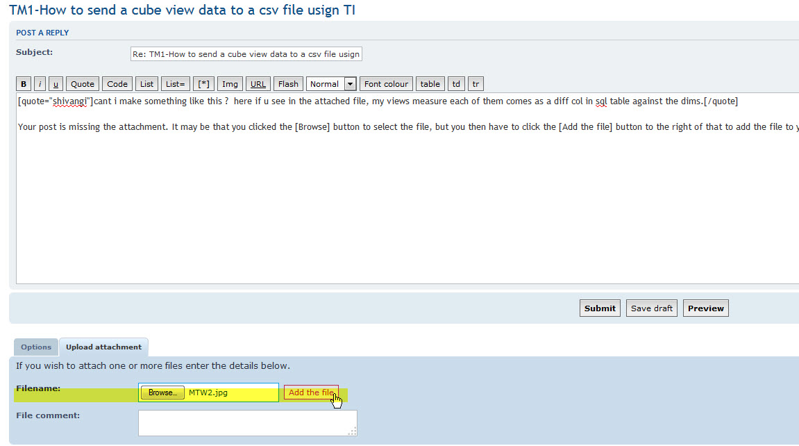

Your post is missing the attachment. It may be that you clicked the [Browse] button to select the file, but you then have to click the [Add the file] button to the right of that to add the file to your post.
