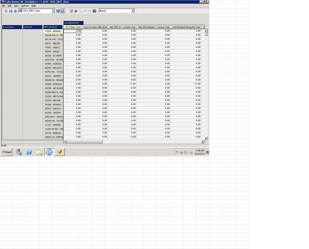

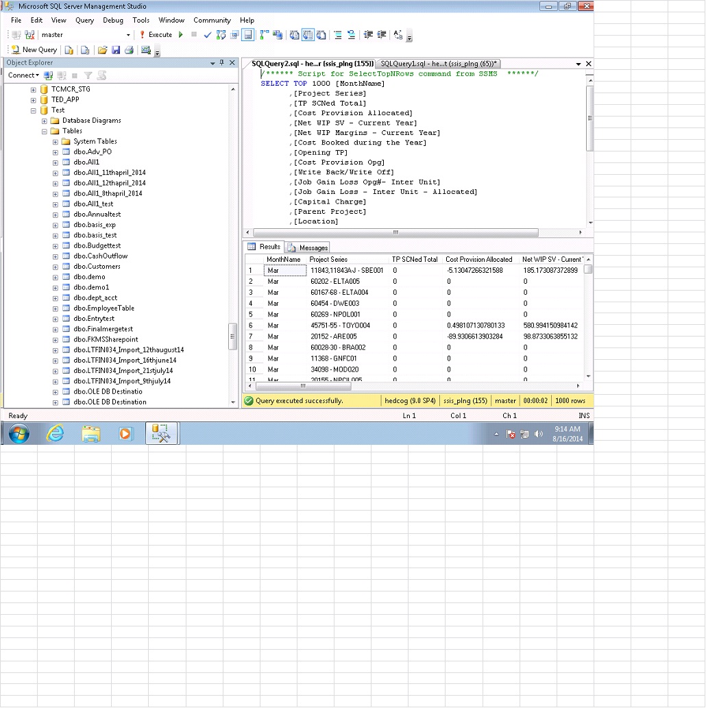

cant i make something like this ? here if u see in the attached file, my views measure each of them comes as a diff col in sql table against the dims.
Re: TM1-How to send a cube view data to a csv file usign TI
shivangi wrote:cant i make something like this ? here if u see in the attached file, my views measure each of them comes as a diff col in sql table against the dims.

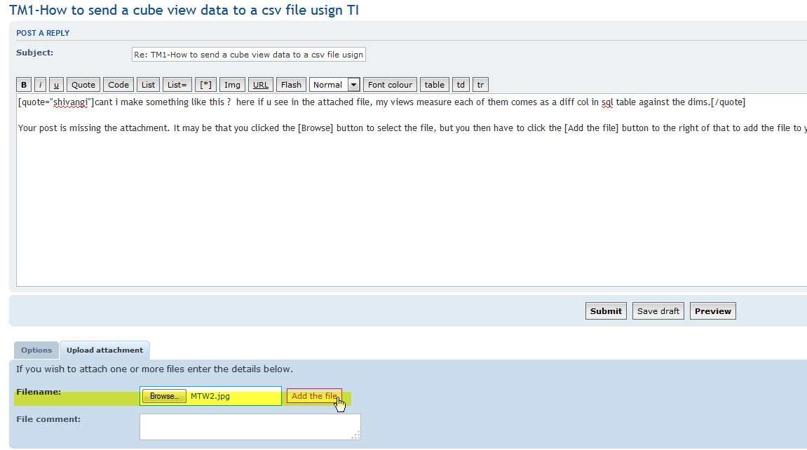

Your post is missing the attachment. It may be that you clicked the [Browse] button to select the file, but you then have to click the [Add the file] button to the right of that to add the file to your post.

sorry, done now.

You can't do what you want without some special coding. This is because when you use a cube view as a data source you get one intersection per record. Your picture shows 5 intersections (the 5 columns). The only way to output these 5 columns in one line in the CSV is going to be to pull one column from the view and then do a CellGetN for all the remaining columns and then configure your ASCIIOutput statement to output the dimension elements and then the 5 measures. You'll also want to create a consolidation of the measures you want and use that in the view. Then you can CellGetN for each of the children of that consolidation and write them out to your file.
