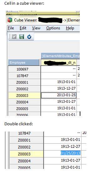

Just one question. I noticed that if I set "yyyy-mm-dd" format, it displays that accordingly, but when I double click the cell to edit it in a cube viewer, the format changes to the TM1 server regional settings (in my case: "mm/dd/yyyy"). Can I somehow prevent it?

Just realized that the reason is in format difference: looks like it's getting confused with server's and my local regional settingsvovanenok wrote:Also I'm not able to copy/paste values
Does Architect use local regional settings?
On attached screenshot you can see how the format changes when I double click the cell

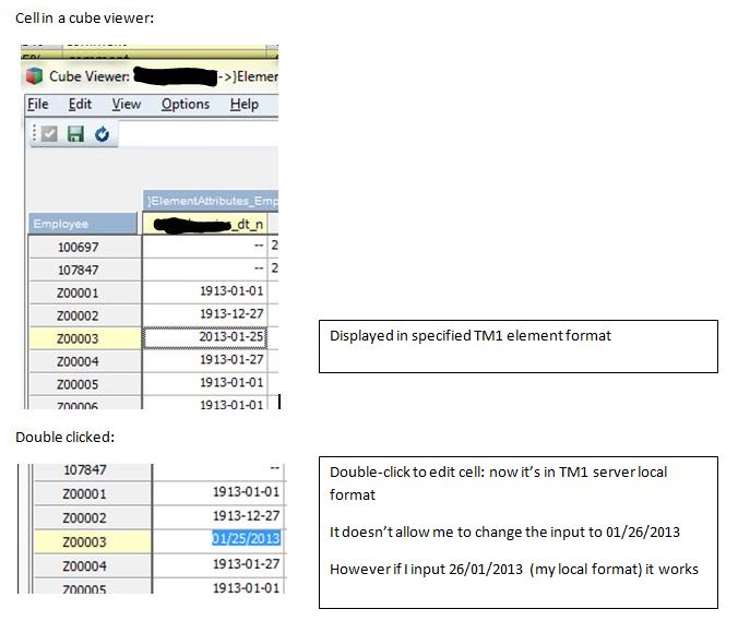

I would like to bump this topic again as my last question didn't get any answer.
I'm trying to use number with custom format (yyyy-mm-dd), but when I double-click the cell to edit it in Architect, the format changes to the server local one (mm/dd/yyyy). However that format doesn't work when I edit the cell. It expects my local machine date format.
I'm experimenting with Jan 25, 2013 so I see where my year / month / day are. Please see my actions on the screen shot below.
Also it doesn't allow me to copy paste values . I'm able to copy/paste values only after changing element format to my local one.
Did anyone encounter such issue?
- Capture.JPG (56.51 KiB) Viewed 10651 times

No solution to your problem, as far as I am aware, Server Explorer has always behaved this way.
