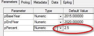

when it is a numeric parameter in TI, in the parameter window, it is showing correctly. But when to run it, it only shows the integer part of this number?
Am I missing something here?

Same thing in both 9.5.2 and 10.2. The decimal value is saved in the .pro file, but when TI loads the prompt dialog it truncates that to the integer value.
Re: Decimal numeric parameter?
I've got around this previously by having 2 parameters (the integer and the decimal), it was being ran from tm1 web so users typed into 1 box then hidden cells split it out. If you want to run directly that would feel cumbersome though.
Could enter the parameter as string then convert it to a number but then you run the risk of people typing stupid things.

Yeah, the only way I can do is to use string and conversion.
