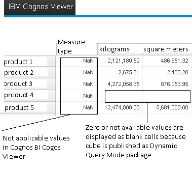

Because of matematical division by zero problem the result is #N/A. This works fine! Bellow is a simplified sample in Cognos BI - Cognos Viewer. It is clearly seen the difference between zero values or not/available AND not applicable.

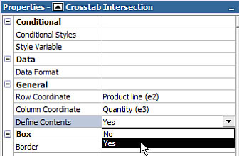

Foremost of all, you can display text in a crosstab! Yes, it is possible. Several years back I had done it. Refer to this IBM KB in achieving it -
http://www-01.ibm.com/support/docview.w ... wg21454433
Secondly, unlock your crosstab, and define the content of the intersection to "Yes"
Drag and drop a string from available objects and put your text. See a sample output below :D
