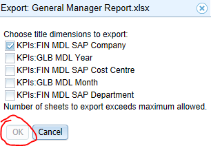

When trying to export any active form or websheet in tM1web 10.2.1 to either excel or pdf I get the following at the bottom of the page and no file is downloaded or nothing really happens.
However when exporting a cube view it all works fine.
This websheet used to run without a problem before upgrading from TM1 10.1.
In some other websheets I can't export to pdf or excel at all. As you can see below whether I select a tittle dimension or not the "ok" button is actually grayed out
Hope anyone can shed a light here
