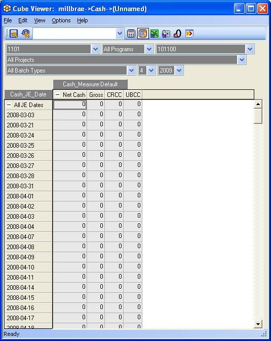

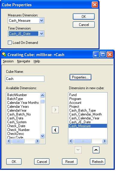

After some thought, I decided to make an audible from the plan. After editing the TI processes for the three data sets to add the measures dimension (and removing some unnecessary dimensions), I created a cube manually with the following elements:

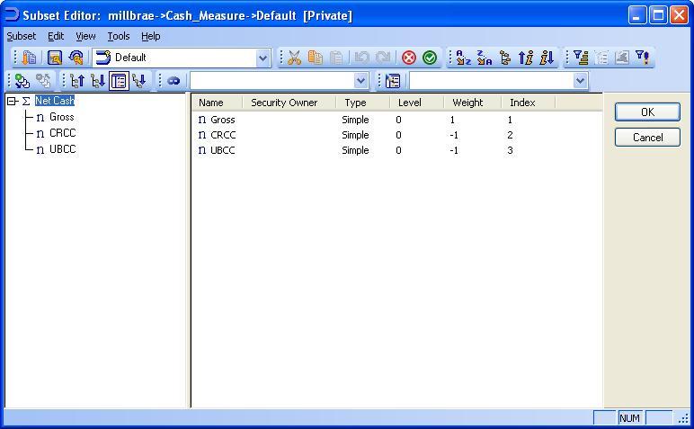

I also edited the measure dimension to add the 'Net Cash' element and change the weight of the 'CRCC' and 'UBCC' to -1:
When I view the newly created cube, I'm not getting any data intersections.
I thought about the view extract for each of the three cubes and decided it was not necessary (and how would I create a TI process that would be able to use three different cube views as the data source?) I decided that the only way was to create the cube manually. I must have missed a step somewhere, but I'm not sure what I'm missing.
