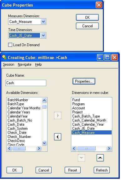

After some thought, I decided to make an audible from the plan. After editing the TI processes for the three data sets to add the measures dimension (and removing some unnecessary dimensions), I created a cube manually with the following elements:

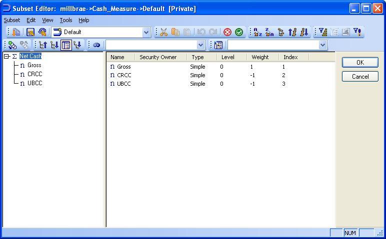

I also edited the measure dimension to add the 'Net Cash' element and change the weight of the 'CRCC' and 'UBCC' to -1:

I thought about the view extract for each of the three cubes and decided it was not necessary (and how would I create a TI process that would be able to use three different cube views as the data source?) I decided that the only way was to create the cube manually. I must have missed a step somewhere, but I'm not sure what I'm missing.

I can't believe it. I think I actually got it. Based on my discussions with the accountant, I know that he attributes the credit cards to only one fund (element in the Fund dimension), one account (cash account in the Account dim), ...etc. I added the dims to the other cubes so that they would be of equal dimensionality. Then I changed the TI processes so that they would update the same cube, just to different elements in the measure dimension. The only part I need to add is a TI process to zero out the data each time the TI processes are run(as I have it set to aggregate values) so there is no duplication. Thank you all for your input. I appreciate it.
