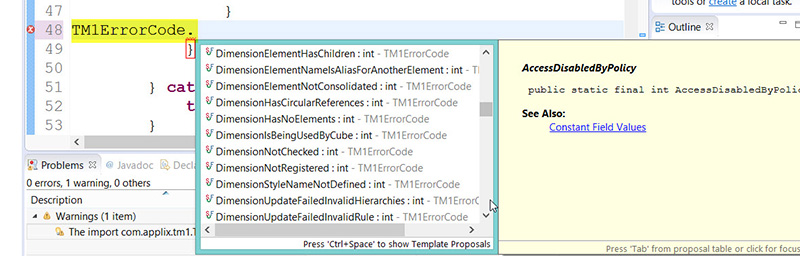

if(oTM1Dimension.isError()){
	// This is OK, we need to create it.
	if(oTM1Dimension.getErrorCode()==TM1ErrorCode.ObjectPropertyNotList){
	//Etc
If it's any other type of error then we log it, and throw an Exception back... you get the idea by now. And if oTM1Dimension.isError() is false, meaning that there's no error at all (and therefore meaning that the dimension already exists), we just skip on to the next one. The only else code that's executed in such a case is a debug statement. But that's of no value to us as a learning tool, so let's continue with the assumption that the dimension was not in the list. What do we do then?

Fixing References
As previously mentioned, [Ctrl] + [Space] is probably the most important shortcut in the application. It loads the list of available objects, properties, methods, code templates, etc, depending on context. For a class, it will also either create the Import statement, or offer you a selection of matching classes to choose from.
[Ctrl]+[Shift]+[O] will clean up your references.
If you have, say,
import com.applix.tm1.TM1Cube;
at the head of your class but have moved any reference to the TM1Cube object in your code, [Ctrl]+[Shift]+[O] will remove it automatically.
Similarly it's possible to declare an Import statement using wildcard characters; for example you could import references to any TM1 objects that you may use by declaring the Import as:
import com.applix.tm1.*;
I'm told that this has no impact on performance. Maybe, maybe not. But it does make your code more opaque than it needs to be to those who follow you.
Consequently [Ctrl]+[Shift]+[O] will convert this:
public class MainCode {
	public static void main(String[] args) {
			TM1Server oTM1Svr;
			TM1Cube oTM1Cube;
// Etc
Into this:
import com.applix.tm1.TM1Server;
			TM1Server oTM1Svr;
			TM1Cube oTM1Cube;
//Etc
