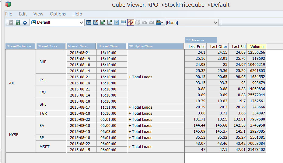

The example that I'll be using is one where we need to obtain stock prices from a web service on the Internet and load those values into a cube. This needs to be done on demand.
Obviously you can't do this entirely within TM1 because there is no native web service data source for TI, and there probably never will be because there are far too many nuances and variations to such data sources anyway.
We could conceivably have an application that pulls the web source into a text file, and have that text file picked up by TM1, but you then need to ensure that the file has finished writing before attempting to load it. This necessarily introduces a gap between the time of the information and the time of availability.
In this case using an API solution seems to be a decent fit because although there are the workarounds that I described above, they don't really solve the key problems.
Of course, I'm fudging a bit here because I won't be using real time stock data. That costs money and I'm not spending it just to write an article. Instead I'll be using the Yahoo Finance API to suck down values from that service which, as with all free stock services, is delayed by about 20 minutes. However first it's free, second unlike Google, Yahoo is not known for arbitrarily pulling its APIs (do a search for Google Translator API Spring Cleaning if you want to learn new and exciting words of profanity from developers), and third, and best of all, there's a Java library that wraps around the Yahoo Finance API which returns the data as nicely formatted objects so that I can focus on showing you the TM1 stuff without having to also show you raw web access code and turning the later instalments of this article into "War And Peace, Volume XII".
The cube is made up of 6 dimensions:
  • SP_Exchange
  • SP_StockCode
  • SP_DateCode
  • SP_TimeCode
  • SP_UploadTime
  • SP_Measure
If anyone saw the Conference version of this during its all too brief screen time, yes, I changed the first dimension because it was bugging me. It was originally SP_Country, but the codes that come from the Yahoo Finance API are actually stock exchange rather than country codes even though I've yet to encounter multiple codes for one country. (P is Paris, L is London, AX (an abbreviation for ASX, presumably) is Australia, and so on.)
The stock code is of course the stock listing code on that exchange.
The date code comes to us from a Yahoo Finance Calendar object (explained later), and is converted into a text string to get the element name. I format it as YYYY-MM-DD and it represents the date that the data relates to.
The timecode comes from the same Calendar object and is formatted as HH:mm:ss, though in reality the source data doesn't appear to have a granularity greater than 1 minute. This represents the time at which the stock data applied, and it appears to represent my local time rather than the local time of the exchange. (The Java library that I use with the Yahoo Finance API seems to provide some methods for conversion but for the purposes of this exercise I haven't felt a need to explore that path.)
The Upload Time is a string in YYYYMMDD_HHmmss format (plus an element called Latest, which receives a copy of the last set of numbers uploaded as well) which indicates when the upload was done. It has a single consolidation called Total Loads which exists not because it has any real world utility, but simply to allow me to show you how to use the API to assign different weightings to elements in a consolidation. (It weights the "Latest" element as 1 and the other elements as 0.)
The SP_Measure dimension contains the elements Last Volume (the volume of stocks traded that day up to the time of the upload), Last Price (the last sale price of the stock), Last Offer (the lowest offer to sell the stock at that time) and Last Bid (the highest price a buyer was willing to pay at that time).
The final Java application can be called by a scheduled TI chore, and it will update the cube accordingly. It needs to:
  • Get the data from Yahoo Finance;
  • Scan it to see if there are new exchange or stock codes and create the elements and update the dimensions accordingly;
  • Scan for any date or time codes that haven't previously been used and add those to the dimension... yeah, OK, I'm slightly lying there. As you'll see when we get to the code, for simplicity's sake I'm not actually checking whether any of those elements exist first. I'm calling the Java API method to add them into the dimension regardless. Just as with the TI DimensionElementInsert function, if the element is already there it doesn't matter. However in a real world solution I'd probably check for the element first and update the dimension only if there were any new ones found to save the processing overhead of doing a dimension update. But a point I shall belabour a little in this article is that this is not designed to be a production system application. Not in the sense that it's unusable (it's in fact quite usable and fully functional and capable of being applied in the real world, as the results in the screenshot below show), but in the sense that at all times it was built with the purpose of teaching specific concepts rather than operational efficiency in mind.
  • Create the Upload Time timestamp code and add it to the Total Loads consolidation, weighting it as zero.
  • Load the values into the cube to both the current timestamp element and the Latest element.
What you end up with is something like this:

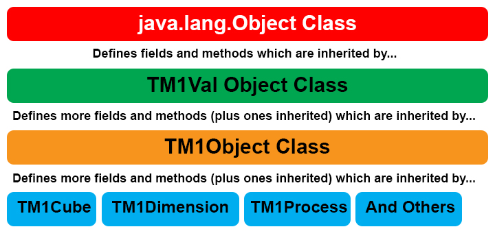

Part 4: About Primitive Values And Complex Objects... And Classes
Java is an object oriented language in which almost everything is an object, so before launching into it it's vitally important to understand the concept of the aforementioned objects (and the classes from which they are created) and, in contrast, primitive data types.
Data types fall into these two broad categories:
  • Primitives. These are single values. They contain no code, and represent only a raw, single value such as a single text character, a true or false value, an integer, a floating point number and so on. When I said that "in Java almost everything is an object", these were the exception.
  • Objects. Have you ever assigned a worksheet to a variable in Excel? That worksheet is an object. An object is sometimes defined quite rightly as being a combination of data and code; that is, a bunch of values which can be stored in it, and some programming code to manipulate those values. Let's look at the characteristics that an object has:
    • Properties (Fields): An object can store multiple values. In VBA these are called properties. In Java they're called fields. Think of a worksheet; it has a sheet name. That's a stored value. The colour of the tab is a value. It has an index, showing where it sits in the workbook. These are all properties describing the worksheet itself but the worksheet can also store other objects as property values; for example, the worksheet's cells collection is itself an object, and is stored as one of the properties of the worksheet.
    • Methods: Most objects have methods, which are procedures which "do stuff". Sometimes that's "stuff" is calculating things, sometimes it's copying, moving or deleting other things. For example a worksheet object will have a delete method to delete it from the workbook, and a calculate method to calculate its cells.
    • Events: In Excel objects can raise events. For example when you change the cell selection in a worksheet, this fires off the Worksheet_SelectionChange event which you can use to write code to handle.
I mention Events only for reference since with VBA (and even VB.Net) the "big three" for objects are always given as "properties, methods and events" but for our work with the Java API only the first two, Fields and Methods, matter.
Variables can contain either primitives or objects, depending on how they're declared.
Similarly either type can be passed as arguments to methods to tell the methods what data they need to act on.
When declaring the data type of a variable in Java, primitive data types will always be in all lower case. Objects (or more precisely classes, which are explained later in this section) should always start with an upper case letter by convention, though since that's not enforced by the compiler it may be possible for some third party classes to incorrectly start with a lower case alphabetic character.

Inheritance
Another important concept to understand in object oriented programming is inheritance.
Say you're writing a whole bunch of different objects, many of which need to have common methods or fields.
One option is to write the code for those into Every. Single. One. of your classes.
Option 2 is to write the code for those into a top level object and have the lower level objects inherit the same code. The inheriting class is called a subclass. The class from which code is inherited is a superclass. Unlike some languages Java allows only a single superclass per class, but that superclass can have its own superclass, which can have its own superclass, which can... keep on flowing quite some way up. In this way inheritance can cascade down several generations.
We see this at work in the TM1 Java API. In the java.lang code library which is the starting point of any Java development (and which we shall see in a future instalment), there is an object called, unimaginatively but descriptively, Object. It is the Big Daddy of all classes. Every class ever written ultimately inherits from java.lang.Object, whether directly or indirectly.
Take a look at the flow of inheritance in the TM1 Java API:
The first of the true TM1 Java API objects is the TM1Val object. Now do not let the name fool you into thinking that this is just for string and numeric values contained in a cube. This object is for all types of Tm1 "things", including references to objects like dimensions, cubes, etc, which may exist on a TM1 server.
We see that the TM1Object class inherits from that. This class relates to those objects that we described above; the class has the core features of any TM1 object whether it be a cube, an element, a chore, etc.
The individual TM1 classes such as TM1Cube, TM1Dimension, etc, then inherit characteristics from the TM1Object class.

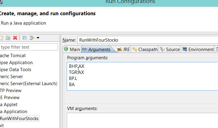

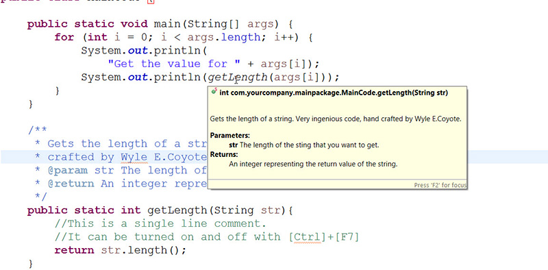

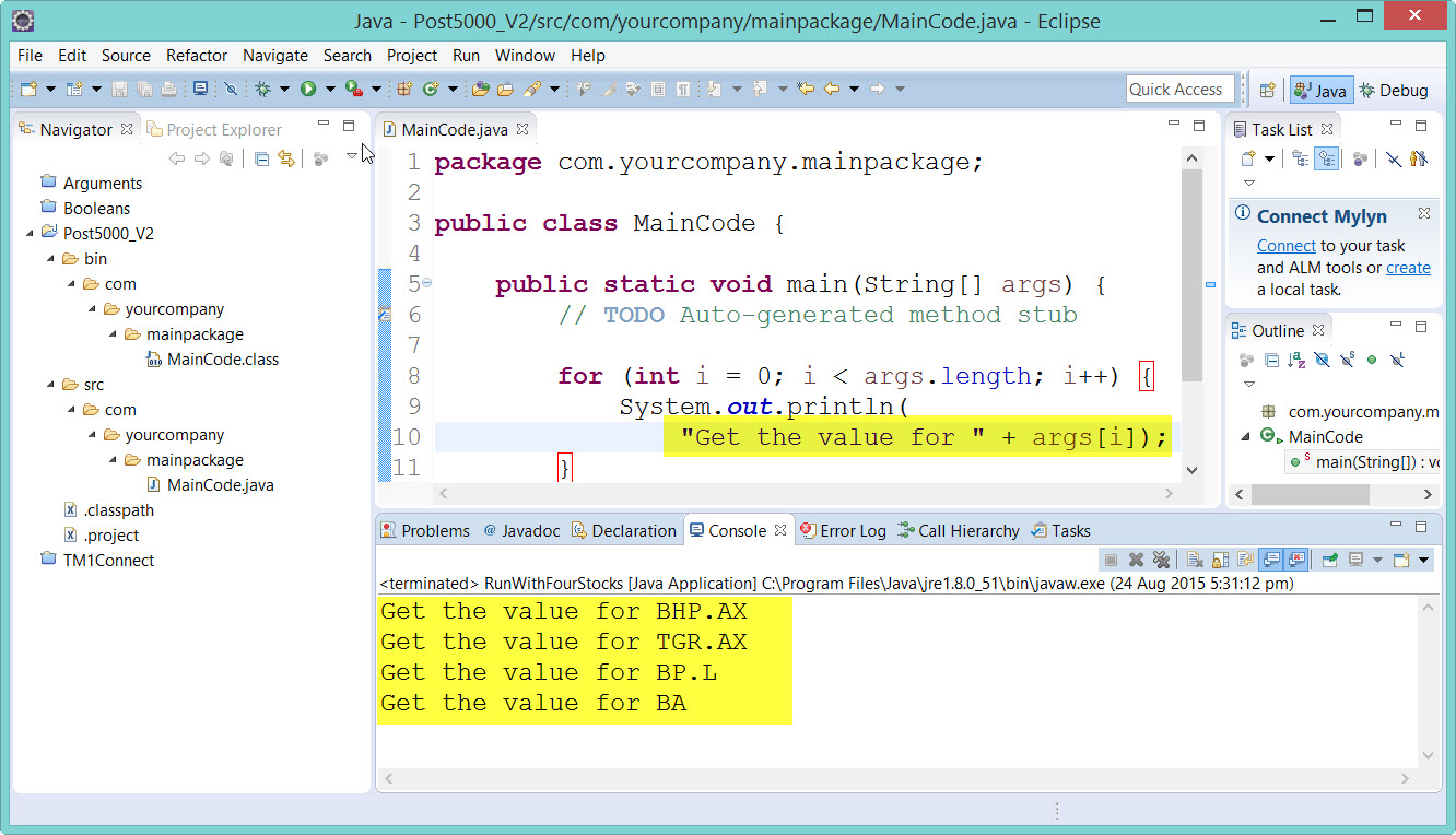

public static void main (String[] args){}
The purpose of the args argument is to receive a comma delimited list of strings from the command line when you call the program. We'll see that in action later on.

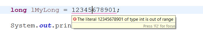

Initialising With (Big) Constant Values
Not so much a difference from VBA but rather an issue to be aware of when working with data types in Java. If you know how big a value a long integer can hold (hint: it's big. Really, really big) you may wonder what on earth is wrong with the code below:
That value is not outside the range of a long integer. So what's the problem? The problem is that unless otherwise specified in Java a constant number is treated as a regular integer. (Note the "of type int" bit in the error description.) And the value above is outside that range. To get around this you need to add an L at the end (so that the initialising value becomes 12345678901L) to tell the compiler that you mean the value to be treated as a long. (For once this is not case sensitive, but a lower case L looks too much like a 1 so most coders use the upper case version.)
You can run into similar problems with floating point numbers which may be interpreted as a double precision floating point rather than just a regular float. In such cases putting an F after the value is enough to get around the problem.

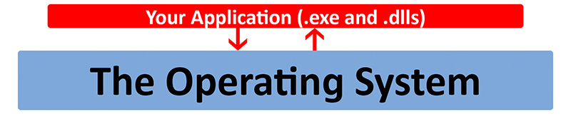

In the olden days computer code was written to run on a single platform (a combination of processor class and operating system) only. To run on different platforms you had to modify the code.
Languages like the original C and Visual Basic 6 had their own compilers, so you would write your code in the format required by the language that you were working in, pass it to the compiler, see it error out, fix the errors, pass it back to compiler, see it error out, repeat the previous process cycle as many times as necessary with ever-increasing hair tearing and anguished groans of frustration until finally the compiler says "Yup, that's OK, here's your executable code."
Which you would then release to an unsuspecting public as version 1.0, and which they would then proceed to break in ways that you didn't even think were remotely possible.

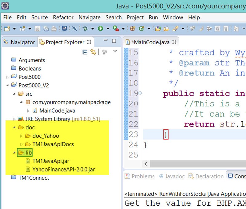

In the case of Java, the first thing to do is make sure that you install the Java Development Kit, or JDK. (Remember this initialism, for we will encounter it multiple times through this article.) That contains the compiler, without which you can't (obviously) compile anything.
Ideally you also need a decent Integrated Development Environment (IDE) like Eclipse (which is freeware), which we'll meet later in this article.
You begin with a new project which has references to, at the very minimum, the JRE (Java Runtime Environment; discussed in the next section) system library. Old style compiled applications also have references to code libraries of course; nobody reinvents the wheel completely from scratch. But it's not that important for our purposes. The Java libraries are, as you'll see. That's in part because Java is a very minimalist language in terms of its core commands. Almost everything you do beyond a handful of commands will be creating objects, setting or reading field values, and calling methods. (Remember this well, for it's a point that you will see time and again in the course of this article.) And a big chunk of those objects, properties and methods will come from the library classes, and the biggest chunk (probably) from the core system libraries.

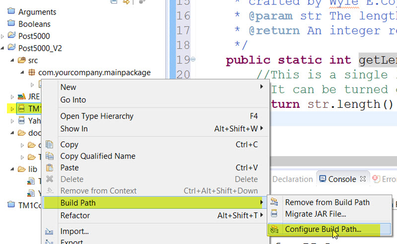

The library contains a bunch of .jar (Java ARchive) files, which are simply zip archive files with a different extension. Within those are "packages" which, although they appear as period delimited names and are often referred to in the code as period delimited names, are in fact a folder structure for storing related files together as we'll see. We'll be creating our own packages as part of the example as well.
Within those packages we have a number of different types of files but the most important of these are the .class files. Those are in binary (computer code) format. And they represent Java code that has been written long before you came along, and provide you with a whole bunch of Java functionality which you can then avoid writing yourself.
This, we will see when we get onto the actual example and create our first project. For the moment, take my word for it.

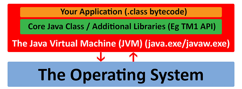

The computer on which you plan to run the code needs to have software installed that can read and run the bytecode in that environment. In.Net this is called the Common Language Runtime (CLR), and in Java it's called the Java Virtual Machine (JVM) or alternatively the Java Runtime Engine (JRE). Remember those initialisms as well, for we will also come across them many more times. (I'll lean more heavily to using JRE because that's the name of the folder that the software is installed in.) The JRE is named java.exe or javaw.exe for Windows.
The advantage of this methodology is that it's possible to write virtual machines which sit over multiple operating system and processor combinations. A virtual machine is written for each operating system (and yes, believe it or not, .Net is also capable of running on multiple operating systems, at least in theory). The virtual machine which is specific to that operating system/processor combination is installed.
When you want to run a Java application you (generally) fire up the Jave Runtime Engine (possibly by having the call included in a batch file to make it easier), which starts the Java.exe / JavaW.exe (as the case may be) executable file.
That loads up the core libraries, and your own compiled code. Since only the JVM/JRE is environment specific rather than your code, you end up with a cross-platform environment. What could possibly go wrong? This:

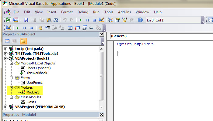

Standard Modules Are Dead
In VBA most of your code is written in standard modules. These are embedded in the containing document, such as an Excel workbook or a Word document. These typically contain subs, functions and variables. The modules are given a name but you don't need to declare the start and end of the module; once created, modules in VBA simply "are" and need nothing further for you to start using them.
Of course this is quite different to VB.Net where you do need to declare the start and end of modules, whether they are classes or standard module. (Not that there's a lot of difference between the two in VB.Net.)

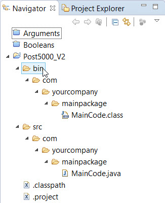

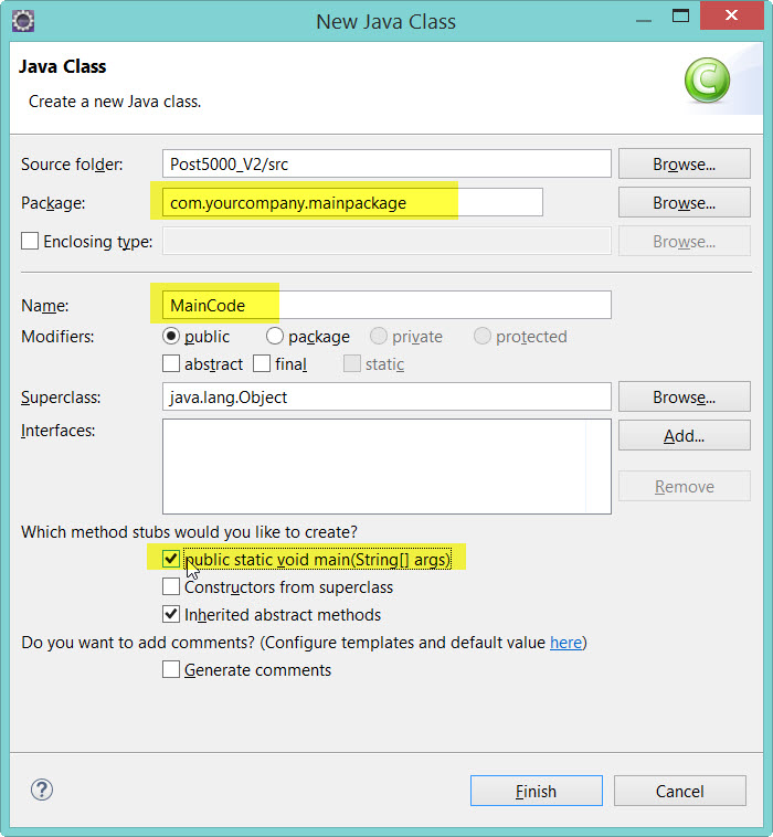

In Java, all code needs to be contained in classes; there is no such thing as a standard module. As mentioned previously, class definitions are plain text files which are contained within a Java project.

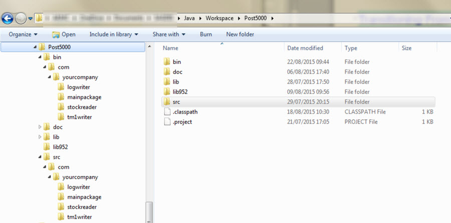

A project is typically contained within a folder. In the example below, "Post5000" is the project. Below this there will be (at the outset) a src folder for your source code. This folder is called the "default package", and should never be used to store source code. Instead you create your own "packages" (which are in fact folder paths). As we can see below there is a folder called com (which should not store anything other than the next folder), below which is a folder called yourcompany (which should also not store anything other than folders), below which are the folders for each group of classes which store your .java source code files.
This is called reverse domain name notation. Since the package location is part of the class definition its purpose is to uniquely identify the code that has been generated at your workplace by using the (unique, obviously) domain name for your website so that if there are two (say) WebUtilities classes in your project, one created by you and one by an external party, it will be possible to distinguish between the two.
Although the packages do represent folders, as we'll see in just a moment within the code itself every reference to them strings the folder names together and separates them by periods. So in this example you would see something like package com.yourcompany.logwriter.

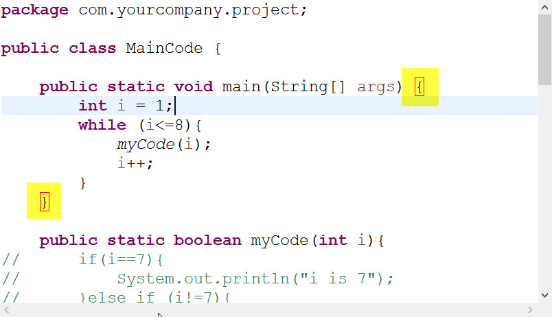

More Braces Than Gordon Gekko's Wardrobe
Unlike a Visual Basic module, you need to specify the start and end points of the class by using the class keyword (lower case) and opening and closing braces. (You can have multiple classes within a .java file but only one can be public (exposed to the entire project), and it must have the same name as the .java file). The opening and closing braces of the MainCode class are shown in yellow below.
Classes aren't the only components defined by sets of braces; any code blocks must have their own sets. In the illustration above we have several groups of code that constitute blocks.
Procedures
There are two procedures; main and myCode. Both of these are methods, and the code for methods must be contained in braces. For main we have an opening and closing brace on the lines highlighted in green.
For myCode they're on the lines highlighted in blue.
There are varying styles of brace placement but the one above seems to be the most common; the opening brace appears immediately after the end of the keywords that define what type of code block it is, and the closing brace appears indented to the same level as the start of those keywords. As an example, note that the closing brace for both methods appears indented at the same location as the process declaration of public static etc.
If, While, For blocks
In the main method we have a while loop (with "while" always in lower case). The while is followed by a conditional test; whether the value i is less than or equal to 8. (I'll discuss this further shortly.) The code that is executed if that condition is true is surrounded by the braces which are highlighted in purple.
In VBA a While would end with a Wend statement (which makes identifying the end point of the code block much easier if you have a bunch of them nested), but in Java you have no such luxury. All code blocks end with a simple closing brace. You can (and as we'll see I often do) add a comment after the brace to show what exactly it's supposed to be closing off.
In myCode we have two code blocks. The first is an if block (and that's a lower case if; if you type it as "If" you'll get a compile error) which is executed if the conditional test i equals 7 is passed. Again I'll come back to the syntax in a moment. The open and close braces are highlighted in red. The second is an else if block (two words, all lower case) which is executed if 1 does not equal 7. (It's rather redundant to do an else if here since if i does equal 7 it will be caught by the if block, but again, this is a training exercise.) The open and close braces are highlighted in pink.
Had we had a for loop (which I omitted for reasons of relative brevity... I said relative), it would do the same thing.
I trust that you're seeing the pattern now. Whether it's if, while, for or whatever, you do the conditional test (which is contained in round brackets), then open the brace, then do the code that relates to the test, then close the brace.
Lunch is for wimps, greed is good, braces are bad but we have to live with them. Gordon would be proud of you.

Capitalisation
Again with the capitalisation, but trust me, in Java, it matters.
Note that the package name in the graphic above (com.yourcompany.package) is in all lower case, the class name (MainCode) starts with a capital letter and is then in lower case except when I'm starting a new word, while the procedure names (main and myCode) start with lower case letters. Most normal methods will use mixed case in the middle, like the myCode method. (This is known as camel case, since it looks like there's a hump in the middle.) The main procedure is an exception because it is the starting point for any console application and must have that name, and exactly that name.
These are very strongly held convention in Java.
While the compiler won't normally throw a compile error if you violate them, experienced and dedicated Java coders may indict you for a heresy and burning at the stake for possible witchcraft is not outside the bounds of possibility.
By following the principles, if you see something starting with a capital letter it can usually be assumed to be a class.
If you see something starting with a lower case letter, it can be assumed to be a method (function) or field (property).

The Comparison (Double = and the .equals method)
This is one that almost certainly will catch you out from time to time, no matter how careful you are. (Unless you work almost exclusively in in Java or other C-related language, anyway.)
In VBA you use a single = sign to assign a value to a variable, or to compare two values. The one that is intended is always clear from the context.
In Java, the equals sign is still used to assign a value. For example:
String sMyString = "";
(Note too that you can declare variables and initialise them in a single line, just as you can in .Net, but not in traditional VBA. This is a welcome difference.)
However to do a comparison, the syntax needs to be:
if(iMyInt==8)
That is, you have to use a double == sign. If you put it as iMyInt=8, you're going to get a nasty surprise, if the code compiles at all.
However, do not, and I'll repeat that with appropriate emphasis, do not use the double equals sign when comparing strings. The reason is that strings are complex objects. As I keep repeating, because you need to hear it. Remember it. Own it as a concept.
If you use the double equals you are essentially asking whether one string object equals another string object, not whether one string value equals another string value. Sometimes you'll get the right result and sometimes you won't.
Check this out:
		String s1 = " Mulder's Apartment Is 42";
		String s2 = new String("Mulder's Apartment Is 42");
		if(s1==s2){
			System.out.println("They match");
		}else{
			System.out.println("They don't match");
s1 is declared using the shorthand syntax. s2 is declared using the longhand full syntax. (I mentioned previously that when you create a new object, using the "new" keyword is one way of doing it. The s2 declaration illustrates this. But because creating a string is such a common requirement the language lets you take a shortcut and simply assign a value straight to the new string object without explicitly instantiating it first. Functionally, though, the two expressions are identical.)
Want to bet what you'll get as a result? Correct, they don't match.
If I change s2's declaration to:
String s2 = " Mulder's Apartment Is 42";
but leave everything else identical, then I'll get the result "They Match".
How do you avoid this?
The string object has an .equals method, which you should always use when comparing strings, like so:
		String s1 = "Mulder's Apartment Is 42";
		if(s1.equals(s2)){
		}else{
This will always return the right value.

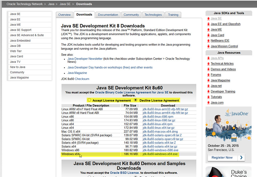

The download pages will probably look something like this (though the specifics may change), even in the distant future:
Looking around:
  • On the left, as I mentioned, are links to the other flavours of Java.
  • Down near the bottom is a "What Package Do I Need" section, which tells you essentially what I have above but with far less style, grace, wit and all round awesomeness.
So looking at the two big buttons on the top, what is this "NetBeans", exactly?
It's Oracle's Integrated Development Environment (IDE) for developing Java code. I've never hear anyone damn it as a curse upon humanity, but nor have I heard much effusive praise. It seems to be a perfectly decent IDE but not one that will rock your world. If you're following along with me you don't need it because we'll be using Eclipse instead, which is a very good IDE indeed and has a pretty large user and enthusiast base. Accordingly just go for the big "JDK" button.
That will take you to another page where you can choose your operating system. As I mentioned Java is cross-platform, so there will be many flavours to choose from. At the time of writing:
Make sure that you select the "Accept Licence Agreement" button after you have read the licence agreement as thoroughly as we all do when installing software, then click on the one that relates to your operating system which, for the readers of this article, will almost certainly be either Windows x86 (for 32 bit Windows) or Windows x64 (for 64 bit Windows). I would hope that anyone reading this wouldn't need to be told this but if you aren't sure which version you're on find the Computer / My Computer icon or Start Menu entry, right click on it and select Properties.
This will start downloading the package to your computer, and I suggest that you opt to save it in your Downloads folder or some other place on your local machine, not to a network location. (Some sites have policies in place which can stuff up installations from network locations.)

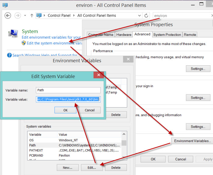

You can modify the environment variables by typing the word environ into the search box of your start menu. (If you have one; if you're on the cursed waste of space that is basic Windows 8 and don't, get one by downloading Classic Shell.) Typing environ on the tile-infected home screen should still get you to where you need to go, albeit more slowly. Alternatively you can go to the Control Panel and get there that way.
Click on the Edit the system environment variables link that comes back from your tab, which will take you to the Advanced tab of the System Properties dialog. Click on the Environment Variables... button to bring up the dialog. Select the Path environment variable and click [Edit...]
I prefer to copy the Variable Value field out to Notepad ++ so that I can see what I'm doing when I modify it; this is a ridiculously tiny window for what is, typically, a very long text string.
I usually add the path to the JDK compiler (not the JRE; we'll come back to that) to the Path environment variable. I do that by making sure that there are no paths to older versions of the JDK in the string, and remove them if there are. (This is why Notepad++ comes in handy; you really can't see this in a small textbox.) In the screenshot above I still had a reference to the old 1.7 JDK , so I'd remove that. Then, after making sure that the previous path in the string had a semi-colon after it, I would add (in my case)
C:\Program Files\Java\jdk1.8.0_51\bin;
Note the inclusion of a semi-colon after the entry. It's not essential for the last entry in the Path variable but is good housekeeping so that you don't have to worry as much about it if you put future values in.
Once that's been done Windows will be able to find the javac.exe compiler without needing to be told exactly where it lives. This is probably not essential when you're using Eclipse (I've known at least one person who wrote Java code without changing his environment variables), but it certainly can't do any harm.

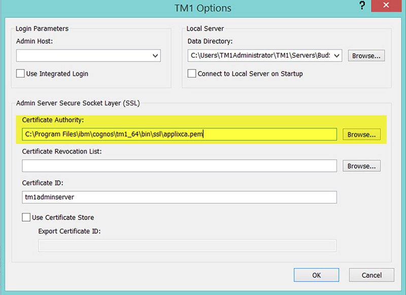

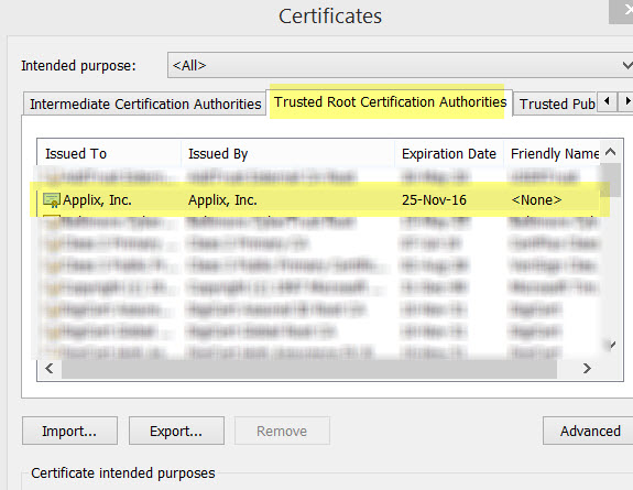

As you doubtless know, later versions of TM1 communicate using Secure Sockets Layer (SSL). This is not the place to be discussing that in detail, and most of the time we don't need to because aside from one or two certificate glitches when SSL was first introduced way back in 2000 and mumble (probably 2006), it has "just worked".
For the standard TM1 Excel client, the path to the certificate is specified in your Options.
Incidentally, .pem = Privacy Enhanced eMail, though it has nothing to do with e-mail any more. It is just a way of packaging / encoding SSL certificates.
With only that one exception way back when, I have never had to worry about that when using either the TM1 client or the classic VBA API. (Though within a couple of days after typing this Brian L identifies it as a potential problem with the C API as discussed on this link.)
Of course, what happens when this rapidly approaching date (10 years after the certificate start date, which is why I said "2006" above) ticks over is something I do not want to think about:
However you do have to worry about this with the Java API. A TM1 Admin Server is theoretically capable of listening on both SSL and non-SSL ports, but in reality current versions will be using SSL. And more to the point I don't recommend trying to bypass that security anyway.
Unless you import the Applix certificate into the JRE's certificate store (explained below), you are likely to be in for a whole mess of errors, not all of which will be obviously related to SSL certificate security. (Note well, not the JDK certificate store, the JRE one which is why I warned you about the extra JRE copy inside the JDK one back in Part 10.) Thankfully doing this is easy.
Understanding what you are doing and why with an almost complete lack of documentation is less so, so let's remedy that.
At the risk of flogging a dead horse, it's extremely important that you get this right, or the API code simply will not work.

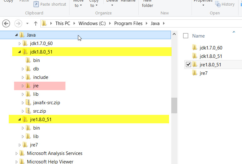

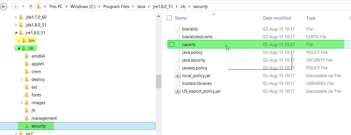

Take a look at the folder structure of the JRE install below. It's divided into two folders, bin for binaries, and lib for libraries. Within lib we have a folder named security. Within that we have a binary file with no extension called cacerts (certificate authority certificates). This is the certificate store for the JRE.
Back in the bin folder we have another file called keytool.exe. This is the program that you use to manipulate the keystore.
And here's how you use it.
  • Open a Windows command prompt. Make sure that you right click on it and select Run As Administrator.
  • Use the cd command to navigate to the main jre folder. In my case that would be:
cd C:\Program Files\Java\jre1.8.0_51
The reason for doing that is because we need to work with files which are under both of its sub-folders, so it's easier to go to the lowest common denominator.
  • Now enter the code shown below, changing the path to the applixca.pem file to match the one on your machine if necessary. (And yes, you do use a mix of forward and back slashes there; read on if you want to know why.)
bin\keytool -import -alias aplx -keystore lib/security/cacerts -file "C:/Program Files/ibm/cognos/tm1_64/bin/ssl/applixca.pem"
You will probably be prompted for a password. Unless you've changed the password on your Java keystore the password will be changeit in lower case.
You will also be prompted about whether to trust the certificate. Type y and [Enter].
So what is this doing?
  • bin\keytool is obviously the path to the keytool.exe program. That's what you're running. Note that because I'm on a Windows machine there is a backslash between the folder and filename; I'm telling the command line to run that executable, so it uses standard Windows syntax.
  • The -import argument tells that program what you want to do; that is, import an SSL certificate. There are other commands available to delete or list the certificates.
  • The -alias argument is optional, but I highly recommend it. If you don't use it the certificate is likely to go in as something like mykey. I prefer to use an alias to simplify finding the thing in the keystore if I ever need to delete it for any reason, or to find it if I want to dump the keystore contents out to a file. Also the aplx expression is just what I chose to use; it has no special meaning beyond that, other than that I was pretty confident that the name wouldn't collide with any certificates that were already in there. You can call it anything you desire, but I've only tested it with all lower case alpha characters so if you stray from that path you do so at your own risk.
  • Now watch this bit carefully; keystore lib/security/cacerts is telling the keytool.exe application the path to your keystore file (that is, cacerts). But note that it's doing that using forward slashes, a fact that caused me some grief early on. Java is not a native Windows language; it was born in the fiery hell-pits of Unix where paths are designated by forward slashes. Even if you're doing this on a Windows machine as I am, you need to use the forward slashes for this argument for it to work. You'll come across this sort of thing in other parts of Java too when working with the file system, but I can't give you a complete guide to when it will happen. However if you are feeding a path to a Java command (which is what's happening here) rather than to Windows (which is what was happening with the call to the keytool.exe), the chances are that forward slashes will be the way to go.
  • -file is of course the path to the .pem file in which the Applix SSL certificate is embedded. Don't blindly copy mine; make sure that you specify your path here. And again note... forward slashes are used to specify this path.
I believe that you can use a parameter named -storepass if you don't want to be prompted for the password, but I've only tested that with deletions and listings.

Version Selection And Download
There are multiple versions for different operating systems, both 32 bit and 64 bit, so choose the one that applies to you. You'll also notice that there's a version for EE developers and an Eclipse IDE for Java Developers one which is targeted at SE developers. According to the Eclipse comparison chart the only thing that EE lacks compared to the SE edition is the WindowBuilder core. Naturally EE contains a great many server-oriented tools that the SE one doesn't.
Given that I know that I'll need to do work in EE at some point and I've already said what I think about Java GUIs, I decided to go for the EE one. You should be fine with either.

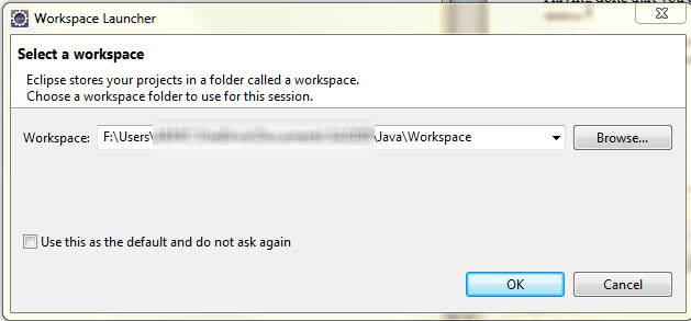

The Workspace Folder
When you start Eclipse it will ask you for a workspace directory. This is where you keep your Eclipse projects and by default it will probably be a folder called workspace in your user folder. Change this if you want.
I keep mine on my OneDrive / SkyDrive folder so that I can move between machines easily (I use four in day to day use, so...), and so that all of my work is backed up to the cloud. Of course that only works because obviously confidentiality isn't an issue for what I'm doing in Java. Use whatever is convenient for you.
Also, it's possible to have multiple workspace folders and choose the one that you want to work in at startup. I won't be demonstrating that, but if you had such a list you would be able to select it from the dropdown shown below.
The first time at bat you won't have any paths specified, so browse to or enter the path that you want to use. If it's always going to be the same one, check the "Use this as default" box so that you don't see this dialog in the future.
You can restore that setting by going to Window => Preferences => General => Startup and Shutdown => Workspaces.
Watch out for one thing; with some versions (Mars in particular) the workspace needs to be updated which will render it incompatible with older versions. When you upgrade Eclipse to a newer version you should do it to the same version on every computer that you work on.

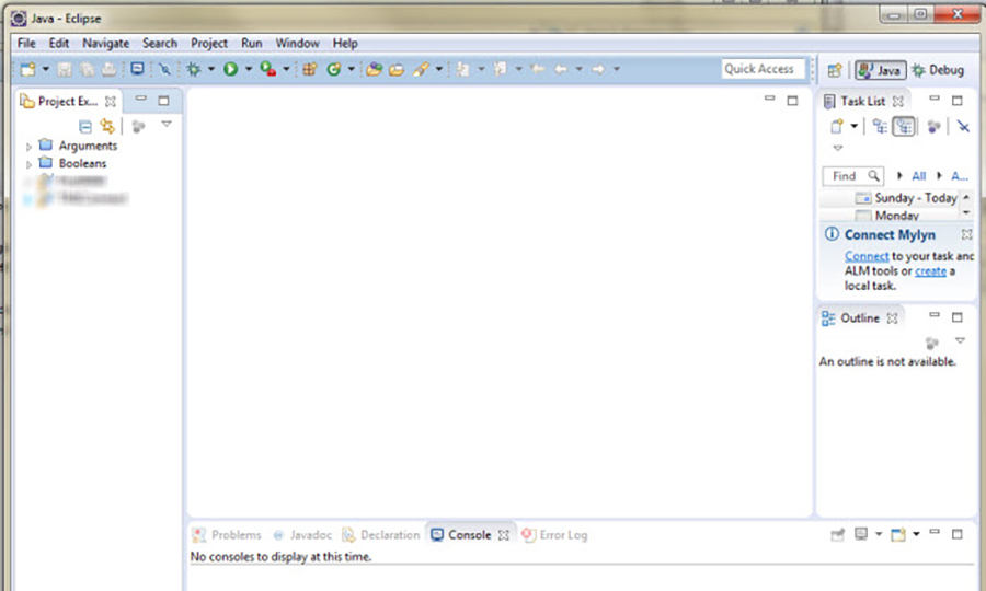

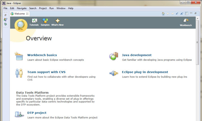

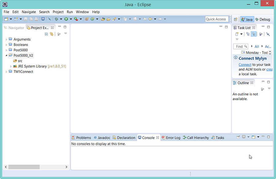

You will typically see the Welcome screen on your first startup.
I don't find this particularly useful, so I just jump to the Workbench using the link at the top right. (Alternatively you can select one of the arrangements of panes (called "perspectives", no, not that Perspectives) at the top left. Eventually the Welcome screen stops appearing, but if you ever want to see it again you can get to it by Help => Welcome.
The tabbed windows on the Eclipse workbench are called "views". If you're used to working with Adobe products like Photoshop these would be known as panels, but "views" is the Eclipse name. An arrangement of the panels is called a perspective. Different perspectives exist for code editing and debugging for example, and as with most IDEs you can create and save your own arrangements.
The Java perspective typically has the following views:
  • On the left, Project Explorer. This shows all of the projects that you have created or imported into the Eclipse environment. It is not necessarily every project that you have in your workspace folder, nor do the projects which are shown here need to be in your workspace folder. Projects can be imported into and removed from the Project Explorer independently of their existence in the file system.
  • In the centre, the main code editing window which needs no explanation.
  • Below that, a number of tabbed windows including Problems (which has a list of any compile errors, unused variable warnings and so on), Javadoc which lets you see the documentation (if any exists and is linked properly) for methods and fields, and others including the Console window to which output will be sent.
    • Incidentally, each time you save your files Eclipse does a background compile to identify any compilation errors without you needing to do a full compile. These errors will appear in the Problems window as mentioned above. But equally if you fix some problems, they may not leave that window immediately. Save the files (using the Save icons on the right hand side of the main toolbar) to do a save and update the values.
  • On the right, Mylyn is a task management plug-in, which we won't be looking at.
  • Below that is an Outline view which provides you with an outline of the current code (if any is loaded), allowing you to quickly navigate to field and method definitions.

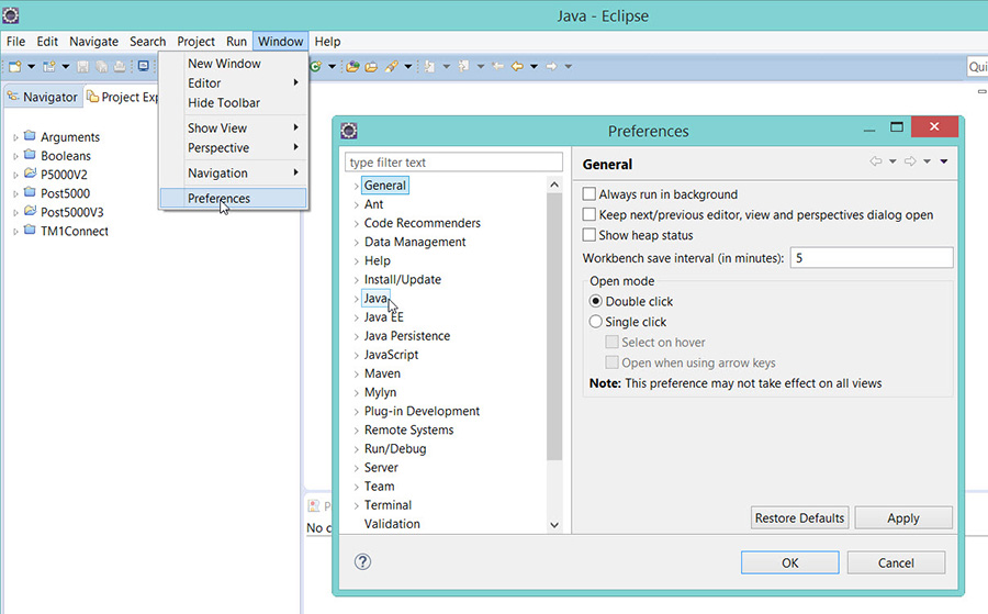

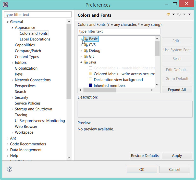

Setting Preferences
We've already seen one of the preference settings (for the Workspace), but the full set can be accessed from Preferences at the bottom of the Window menu. The full range of configuration options for Eclipse is overwhelming, but for the most part you need only a handful of them.
Note that there is a General set that applies to all projects, and a more specific set that applies to the various languages and modules that Eclipse deals with.
If you want to change the size of or colour of your font, you can do that through the General twirl-open. The generic font and size is set in the Basic group, which I haven't opened in the example below. The Java set defines colours and formats which are specific to Java language elements, just as there are other twirl-opens that relate to other languages. As you can see at the top of the box, you can search for the elements that you want to format. I would suggest leaving that alone unless you really need to.

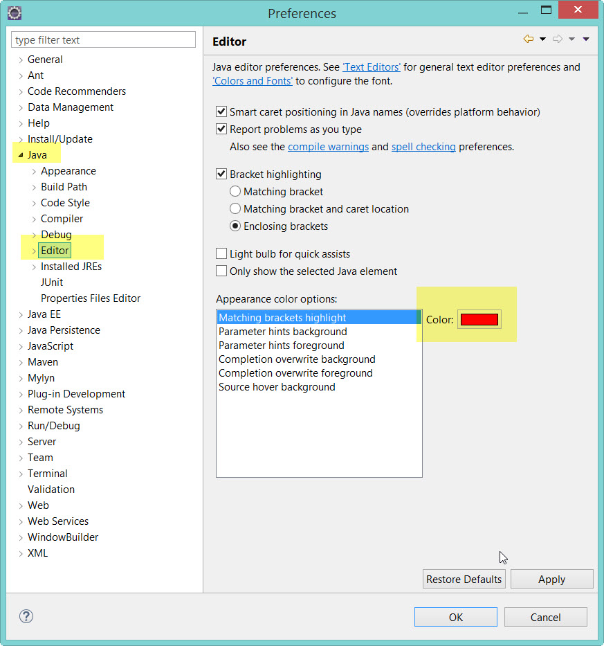

However there is one thing that I suggest you change in the Java section of the left hand pane. (Not the General section illustrated above, the Java one illustrated below).
Click on the Editor twirl-open. (Don't twirl it open, just click on it.)
Change the Matching Brackets Highlight colour to bright red as shown. By default it will be some kind of hard to see grey. My preference is also to change the bracket highlighting radio button to Enclosing Brackets as shown.
What's the effect of that? When your cursor is inside a set of braces and both of them are visible on screen, both will be lit up with a nice, red box. It helps with being able to match them off, especially if you've copied code from another location and you missed a closing bracket:

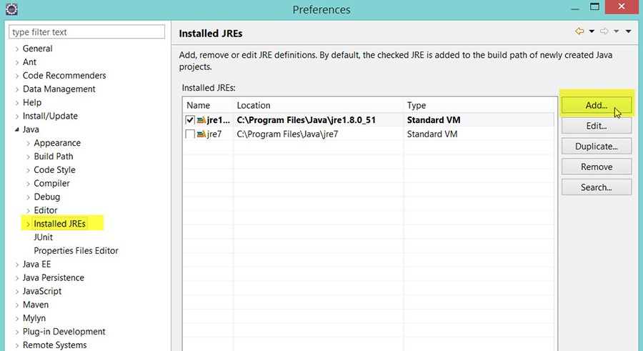

Preferences - Path To The Compiler
There is one important preference that you hopefully won't need to worry about, but just in case...
If for some reason Eclipse couldn't find the path to the JRE, you need to specify it so that it can do the background compilation. (And running the code when you test it.)
To do that, go to Java => Installed JREs. If there are none defined, click on Add... and follow the prompts. (Name is obvious, Location is obvious, and for our purposes you'll always select Standard VM.)

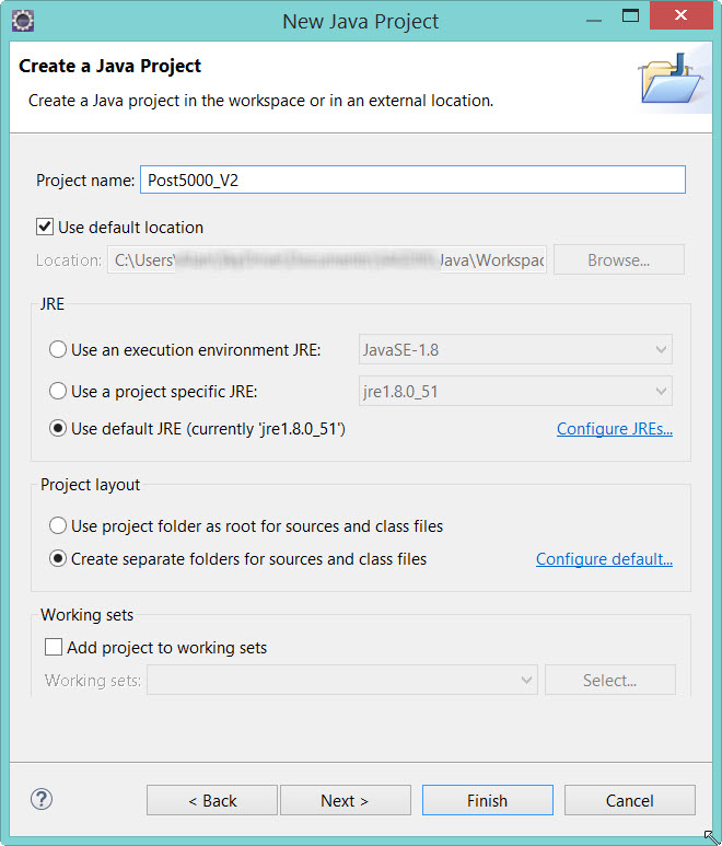

Obviously the starting point is to create a new project.
In Eclipse, right click anywhere in the Project Explorer view and select New => Project.
Depending on the version of Eclipse you're using you may be prompted to choose a project wizard. If so, find the Java Project option from the list and choose it. You should then be presented with a dialog like this (or, if there was no Wizard selection, you may go straight there):
Generally the only thing that you need to enter is the project name.
The Use Default Location checkbox means that the project will be in a new (automatically created) folder under the path that you set as your workspace directory the first time you started Eclipse. You can uncheck that if you want to save it somewhere else.
The JRE allows you to target the code to a specific version of the JRE (which you would need to have installed). If you set this to say 1.7 but used language features that were added in 1.8 then I imagine that you would get compile errors, though I admit that I haven't tested that.
Generally if you're writing code for your own use you should just go with the default JRE and make sure that that version or higher is installed on all of the machines that you use.
The Project Layout allows you to specify whether:
  • You will have your .java plain text source code and .class compiled bytecode files somewhere below the project's root folder; or
  • Whether the .java files go into a folder named src and the .class ones into a folder named bin.
There is no good reason for dumping everything in the one folder, unless you're the kind of person who likes throwing everything into your wardrobe and having an adventure trying to find it again.
Working sets are an Eclipse feature that allow you to group projects and other resources into groups when you start to have long lists of them. We won't go into them further here. At the bottom of the dialog there is a [Next] button which will take you to a further dialog that you really don't need to do anything on when you're still getting up to speed with Java, but should probably take a peek at for curiosity's sake:
You could, for example, include new source code folders, or change the folders that your .class files will be output to. Or you could add references to other .jar libraries including external ones (that is, ones which aren't part of your project folder) on the Libraries tab. But I'm not going to do that, and we'll see why shortly. Aside from which any of these things can also be easily done from inside Eclipse after you have started coding. You don't need to do it here.
Click [Done] to create the project.

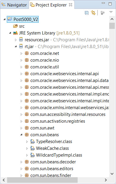

The content of the new project is pretty sparse. The Project Explorer shows only a single folder called src and a reference to the core Java libraries, named here as the JRE System Library. Note that it has jre1.8.0_51 next to it indicating that it relates to that version. Had I created the project to point to version 1.7, it would have had that version instead.
The src folder is where all of your source code will go, as you would expect. We'll create some in a moment.
As I mentioned earlier, Java code is compiled to bytecode (binary) .class files which are packaged into .jar (Java ARchive ) files which are Zip format archives with a different extension.
In fact the core libraries contain other types of files as well, but as Java novitiates looking at those is way beyond our current paygrade. Strictly speaking we never need to drill down into any of the files in there; instead we're far better off using the Java documentation to find the classes that we need. However just out of curiosity:
Looking at the rt.jar archive, we find that it contains packages. As I discussed oh so very long ago now, packages are in fact folder structures and we'll create our first one in just a moment. One of the packages, originally written by Sun Microsystems and therefore using com.sun as its reverse domain name notation system, is the com.sun.beans one. And that contains three classes which... actually I have no idea what those ones do and care even less just at the moment. The only thing I wanted to illustrate is "that's what the system libraries are".

Yeah, let's do that, my fingers hurt. We'll call it mainpackage (all lower case for package names, remember).
Our class will be called MainCode. It's a class so we use mixed case, always starting with a capital letter.
Creating it is as easy as right clicking on the project entry in Project Explorer and selecting New => Class
That launches the New Class dialog:
The default source folder is the src folder that we saw above inside your project.

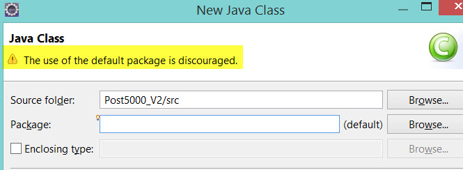

The Package, you can in fact leave blank in which case the class will be put directly under the src fdolder. That's called the default package, and putting your code there is a very bad idea. Eclipse will warn you about this. Not in a "are you crazy, I'm not compiling that!" kind of way, but there will be a warning at the top.
OK, it looks like this if you must know:
So to avoid that, we are putting it into a package as shown earlier.
Disregard the Enclosing type checkbox, that's way, way down the advanced coding track.
The name of the class is obvious. As this will be our starting class, it has to be public, so that's fine. Abstract and final are also further down the Java learning path than I'll be taking you.
The Superclass should be obvious if you stayed awake through the section on Inheritance. This class will inherit methods and properties only from the absolutely top level class.
Interfaces are down the path alongside abstract and final. You don't need them yet.
One thing that I did change was to check the public static void main checkbox. You do that for your very first class and your very first class only. As I have mentioned repeatedly, the main() function is the starting point for a console application. It's where the code starts running. You need to have one, and only one. And since this is the only class we'll have for the moment, it needs to have a main function. You can create it manually of course, but there's no reason not to let Eclipse do it.
The other items can be left with their defaults. When you click on [Finish], this is what we see:

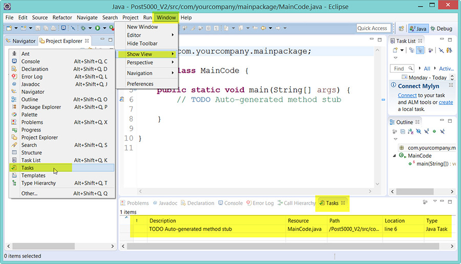

Tasks And TODO Items
Incidentally, when you write a comment in that format (with TODO immediately after the double slashes) you can open a view (panel) called Tasks which will show you every entry in the project which has TODO comments, like so:
Project Explorer Vs The File Structure
The last thing to be aware of here is that if you're relying on Project Explorer to show you what's happening on your disk system, then I'm afraid I have to tell you... it's lying to you. Not in an Ashley Madison way; it actually has your best interests at heart by keeping the view decluttered and restricted to content that affects your source code. Thus it shows packages as a single "thing" and doesn't show you the compiled .class files at all.
If you want to see that, open the Navigator view from the Window => Show View menu item. You'll see this:
This shows what's really happening under your project folder on your file system, the same thing that you'd see if you looked in Windows Explorer. There is now a bin folder (not shown in Project Explorer because it isn't relevant to the creation of source code), under which there is a separate folder for each name between the periods in your package name.
Because we elected to have source and compiled code separated when we first created the project (see that dialog earlier for details), that package tree structure is replicated under both the bin and src folders.
There are two system files, one named classpath (which is used to tell the JRE where to look for compiled classes when it runs), and one named project, which contains information about the project for Eclipse's reference.

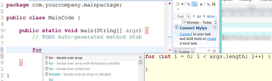

Iterating The Array, For Loops And Eclipse Templates
Iterating the array is easy. We want to do a for loop. All I need to do is type the word for and then press [Ctrl]+[Space]. As I mentioned earlier, that is arguably the single most important keystroke you can learn in Eclipse.
It launches a number of templates relating to the word "for":
The first suggestion is "iterate over array", the skeleton for which is shown in the pop-up to the right so that you can get an idea of what you'll be getting if you select it.
The conditions for a for loop are, as is the case with many other keywords, enclosed in round brackets. There are three arguments in this syntax:
  • The first defining a counter variable and setting its starting value. Note that this is int i (which declares a variable i with a data type of integer), followed by =0 (which initialises its value). There are two things to be aware of here. The first is that because i is initialised within the for loop, it only exists inside that for loop. If for whatever reason you have to use it outside of the for loop, then declare it outside and simply initialise it to zero in the first argument to the for loop. The second is that as I have previously mentioned, arrays start at zero in Java which is why the code template sets it to that value.
  • The second stating how long the loop will run for. As I mentioned, arrays in Java are complex objects and therefore have methods. .length is one of them; it defines how many elements the array has. Note that the condition only runs while i is less than that length, again because arrays start at base zero. Eclipse is smart enough to know that it needs to loop through args because it's the only array in sight.
  • The third stating how to handle the counter each loop. In this case it uses the increment operator that I mentioned previously to increment the counter by 1 each time (equivalent to i = i+1)
This is followed by opening and closing braces defining a code block.
One more time, whether it's an if, a while, a for, a try, a catch, a finally, a method, a class... everything after the definition will be a code block, and must therefore sit inside braces.
So all we need do is hit [Enter] and the code will be inserted for us.

So let's say that I write it this way:
Things to note about the above:
  • With my cursor on row 10 you can see how the braces are highlighted after I set up the Eclipse preferences. It matters less for small blocks like these but with large, nested blocks that can really help you find your way around.
  • Note how I split the println statement over two lines. With the semi-colon required as a line end terminator it's easier to do this in Java than in VBA.
  • As I mentioned before, the + operator is used to join strings as well as for addition.
  • The current element of the args array is accessed using square, not round brackets. That takes some getting used to if you're from VBA.
Running The Application

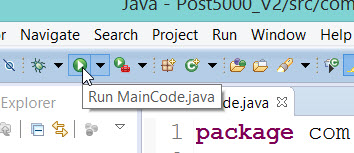

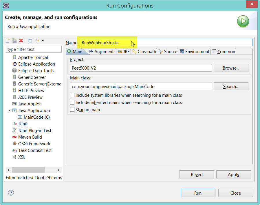

Right, we're all set to go! To run the thing we go for this green play button up here on the toolbar,
so let's hit that, and...
Absolutely nothing happens. Why, whyyyyy?????
Because we haven't faked any arguments yet, that's why.
Instead of clicking on the button, click on the drop down to the right of the button and chose Run Configurations.
The first thing we'll do is give the run configuration a name; I'll call it RunWithFourStocks:
Note that if you already have a run configuration and change it here, then you are just changing that configuration, not creating a new one. There is no Save As button. If you want to create a new one, click on that first button way up at the top left first.
The astute reader will note that there are multiple things that you can set here including even a different JRE to test compatibility. But the only thing we're interested in is the variables, so I'll select that tab and add in four stock codes; BHP, Tassal, BP in London, and Boeing.
It seems that you can enter them either on new lines, or as a comma delimited list; either way worked for me:
When I run that configuration:
We have output, and if you've been following along we now have our first functional Java code. But let's not forget what our code does, or get around to documenting it "someday".

Now if I add the details of the method to the first line and some information about the parameters and return value:
	 * Gets the length of a string. Very ingenious code, hand
	 * crafted by Wyle E.Coyote.
	 * @param str The length of the sting that you want to get.
	 * @return An integer representing the return value of the string.
Note that I have added an extra line above the @param entry; Eclipse automatically added the asterisk when I pressed [Enter] as it knew that it was in a comments block.
So what's the advantage of doing this?
First, using standard blocks like these can help you generate standard format Javadocs so that you can have a reference for your classes, methods, fields, etc. This is something that we won't be going into.
Second, when you're coding you get this when you call a documented member:
(Note that the split lines in the source comment have been joined back together again. You therefore don't need to worry about positioning the splits "correctly" if you need to split comments about the procedure up over several lines to keep them readable in the editor.)

As we know, Java comes with a whole raft of prebuilt system libraries containing probably thousands upon thousands of class methods to help you do an immense number of programming tasks right out of the box.
Yet sometimes it isn't enough, and we need to turn to third party libraries.
In my case I need two. One is obviously the TM1 Java API .jar library.
The second is a library to wrap around the Yahoo Finance API, and this one illustrates an interesting point with Java development. I don't in fact need the Yahoo Finance library at all. Java's core libraries contain everything I need to make a call to the raw Yahoo Finance API. However many of Java's functions are very low level and you need to bolt a lot of them together to get the result that you want. And if someone has already done that, as is the case with Yahoo Finance, there is no need at all to do it yourself. Instead you just import that library, and call its classes and methods.
A good source of such prebuilt code is the Apache Commons (https://commons.apache.org/), which is worth checking out.
So where do we put that code?

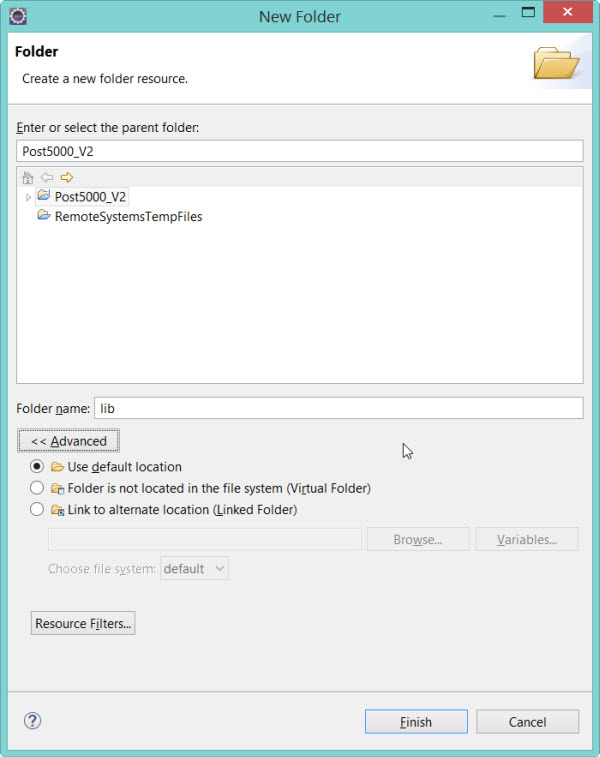

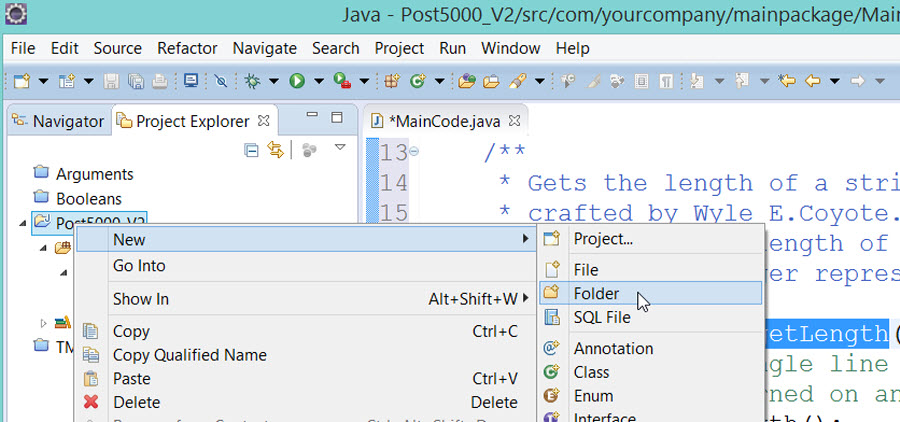

The lib Folder
If we want to incorporate it directly into our project (which I will be for both of those) the traditional place to put it is in a folder called lib for libraries. In Eclipse simply right click on the project and select New => Folder and name it lib like so:
The dialog does allow you to specify some advanced options like whether it is a virtual folder, but we won't be using those.
The doc Folder
At the same time as I create a lib folder I create a doc folder. Those folders are commonly found in Java projects but I'm not sure whether they're meant to hold a project's own documentation exclusively, or imported documentation as well. (I can't find a definitive answer on this one way or the other.) However that's how I'm going to use it.
Downloading The Yahoo Finance Library
This is optional but you won't be able to work along with me if you don't do it. The Yahoo Finance API library can be downloaded from this location:
http://financequotes-api.com/
The download is a conventional .zip file which contains both the various .jar versions (I'm using the 2.0 one only) and a folder containing the Javadoc files for documentation.
Crack open the zip file, extract the 2.0 .jar, and copy it to your new lib folder. (You can copy the .jar file in Windows Explorer and paste it directly into the lib folder inside Eclipse but you have to extract it from the .zip archive first. You can't paste straight from a .zip archive into Eclipse.) There's no point having it stored outside of the project's lib folder since it's not likely to be used with any other projects.
Now rename the doc folder that you extracted from the .zip archive as doc_Yahoo. (Or something that makes it more unique than just "doc".) Copy that into your doc folder in Eclipse. We'll use that later.
Getting The TM1 API Library
One thing to be aware of; it would be possible for you to set a reference from Eclipse to the existing location of the TM1 API .jar. You will see, for example, that there are references to "External Jars" that can be set.
I'm not going to do that, I'm going to copy the thing into the lib folder of my project. Why? Because I don't trust IBM not to make changes to the .jar file in an update package and if the application suddenly stops working for any reason, I want to be sure that the API library changing under my feet isn't that reason. That having been said, if you do a server upgrade, make sure that you don't hit a versioning issue with the API library. You probably won't; I developed the example across both 9.5.2 and 10.2.2 and the only time I had a problem was when I was using the 10.2.2 .jar to try to connect to 9.5.2 by accident. The other way around seemed OK.
Needing to do that check is a disadvantage of loading the library into your project, but it's a disadvantage that I'm prepared to wear to make sure I know what changes and when.
In a standard 10.2.2 installation the .jar will be found here:
C:\Program Files\ibm\cognos\tm1_64\bin\classes\TM1JavaApi.jar
Of course, whether that will still be true after 10.2.2, who knows. If you're on any other version, or installed to a non-standard location, just do a search for a .jar file of that name.
Copy the .jar into your lib folder. Again you can paste the thing straight into Eclipse.
The documents will be here:
C:\Program Files\ibm\cognos\tm1_64\TM1JavaApiDocs
Copy that folder (the entire folder, not just its contents) into your doc folder.
You should end up with something like this:

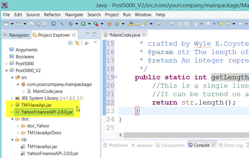

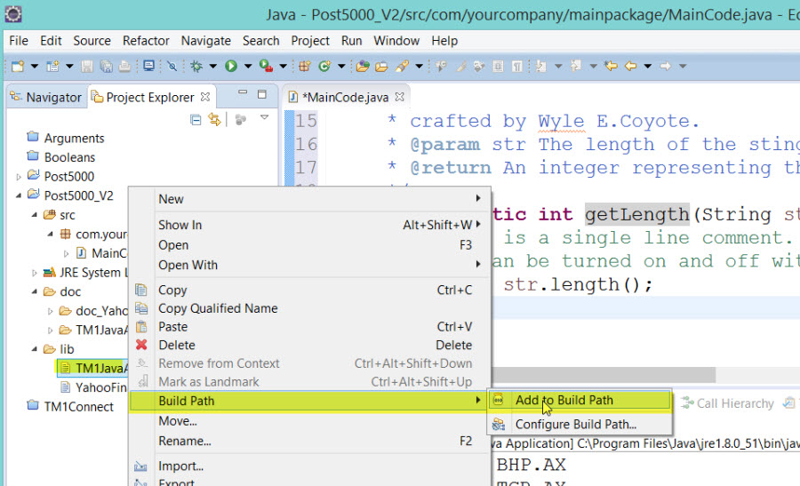

The first thing is that we need to tell the compiler (via Eclipse) that we need these libraries included when we build the project. And in Eclipse this could not be simpler.
For each of the libraries, right click and select Build Path => Add To Build Path
If you've done this correctly you will now see the libraries up alongside the JRE System Library like so:

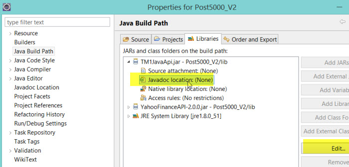

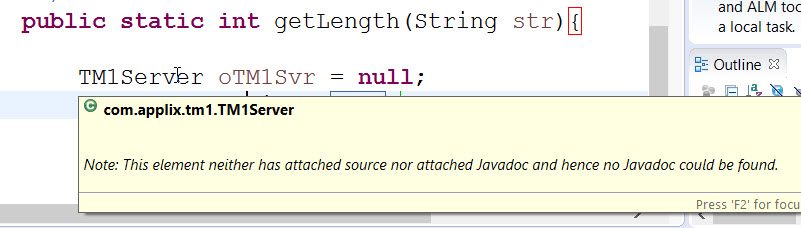

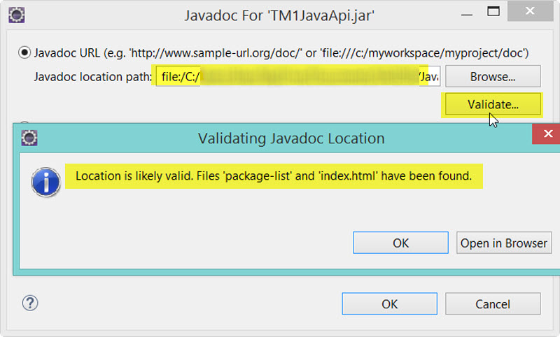

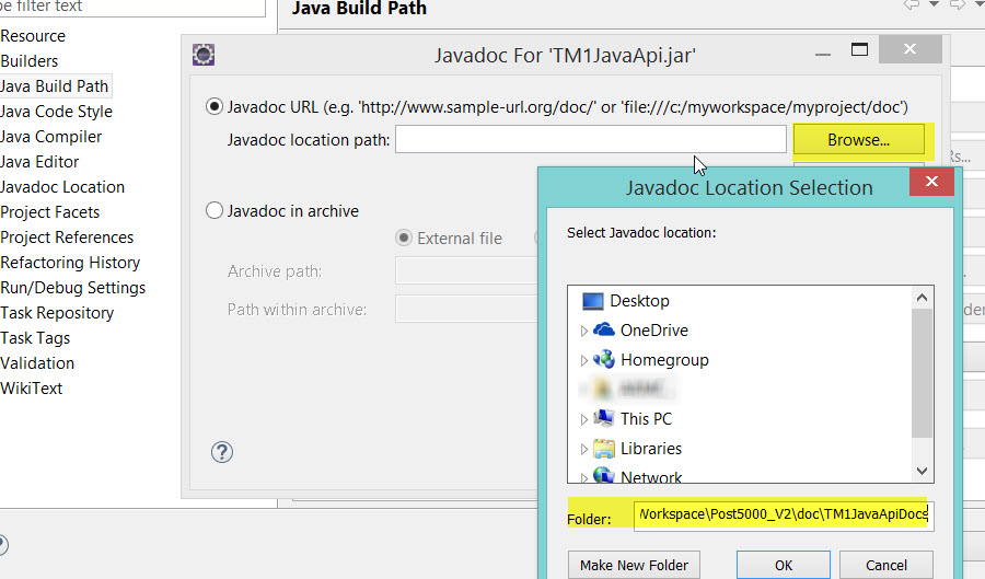

Now that is in fact enough to make them work. But we will still be missing one nicety; remember that helpful little tag that popped up over the Wyle E Coyote process a couple of parts back? We won't get those, because the libraries have no idea where their documentation is. Instead we get this:
Thankfully that's an easy fix as well. Right click on the library in question (either the one in the lib folder or the one up with the System libraries, it doesn't matter which) and select Build Path => Configure Build Path.
Go to the Libraries tab and select Javadoc location. You can either double click on it or single click and select Edit.
Now unless you're feeling really confident about your Java file system syntax, I do suggest that you use the [Browse] button. You can paste the path to the Javadocs (which we have in our Docs folder) into the Folder field of that, but don't try to do it into the Javadoc Location Path because it needs to be filled with forward slashes and such as you'll see from the screenshot after the next one.
Once you've selected the path, click on the [Validate] button. That doesn't guarantee that you've hooked the help files up correctly, but it checks for the presence of expected files which are essential for a valid Javadoc pachage:
If all is well, check out the difference:
As the bottom right of the pop-up states, you can press [F2] to jump into the dialog so that you can scroll through its whole content.

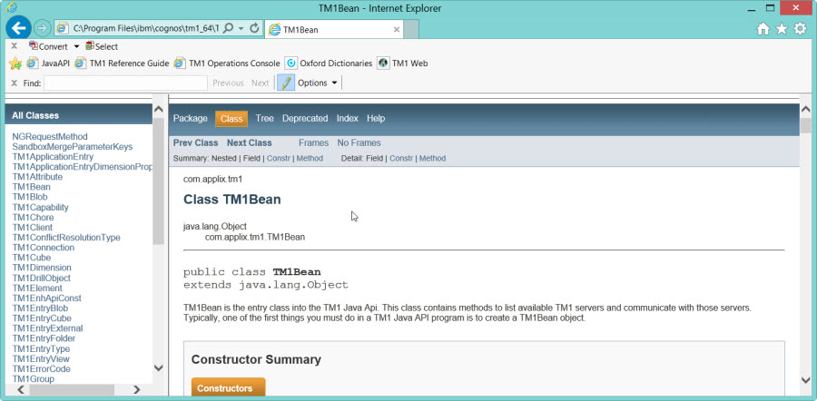

Loading The Java Docs In Your Browser
But just before we do, you should also be aware that you can open the JavaDocs library in your browser, which can make finding methods and fields easier.
In a default 10.2.2 installation you should find the home page at:
C:\Program Files\ibm\cognos\tm1_64\TM1JavaApiDocs\index.html
I would recommend navigating to the folder specified and double clicking on the index.hrml file to launch it into your browser, then bookmarking it (adding it to favourites, whatever your browser does) so that you can easily get back to it.

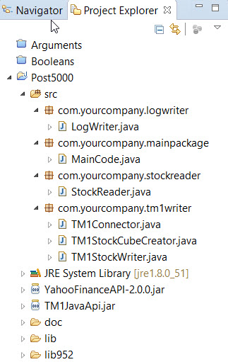

The Packages And Classes
The application is broken into four packages:
They are:
  • logwriter contains a single class (LogWriter) whose purpose is to output any error messages to the server's log directory.
  • mainpackage contains the MainCode module, which contains the main() procedure plus some private (class module level) variables, and nothing else.
  • stockreader contains the single class StockReader.
  • tm1writer contains three classes:
    • TM1Connector, the methods of which are called to create a connection to a server,
    • TM1StockCubeCreator which creates the stock cube if it doesn't exist;
    • TM1StockWriter, which takes the data that was obtained by the StockReader class and writes imert to the cube.
Now let's look at that from a production system perspective, bearing in mind that the decision of what to make a class and what to put in a package is as much art as science.
Should LogWriter have its own class and package? Probably yes, because if it was a serious attempt to create an easy to call log file generator it may be reusable in other projects. (Though if you looked hard enough there's probably already a class out there that will do this and more. But let's suppose that it had some functionality that was specific to our business.) Indeed it could be packaged up as part of a .jar library of our own at some point. Of course this particular LogWriter is nowhere near that good but that's only because it's a demonstrator.
What about StockReader? Maybe. The primary method of this takes a list of stocks and returns it as a collection of Stock objects. (Stock classes being defined in the Yahoo library.) It's quite possible that we could have a need to use this to populate other databases, so there might be some justification for that if we need to reuse it.
That having been said, Eclipse supports a feature called Refactoring which allows you to rename objects, shift them to another package, split code from one procedure into another procedure and so on. We won't be looking at that in this document but it does make it very easy to split code that was originally thought to be "single use" into a library.
TM1Connector? Probably not. The code is trivial and only exists so that I can break out methods to show you the way to connect to TM1 in detail, and in isolation. The methods could just as easily be embedded in the MainCode class.
TM1StockCubeCreator? A bit of a coin toss. In reality you would expect this cube to either already exist or not; there would be no need to load up a data loading application with work like this; work that you would expect to be a one shot deal. That said, it would make sense if this was the sort of application that you needed to deploy across multiple servers and you had to create the same cube and dimensions over and over again. Or alternatively if the cube needed to go through many iterations in development; it's easier to tweak some code than manually tear down and rebuild a cube. (But then, both of those would be just as easy to do in T.I.) If I was building some kind of temporary cube for each run of the application then I'd add cube building code in. For something like this... the only reason it's there is to demonstrate the coding techniques, not because I think it would be useful in production code.
TM1StockWriter? With both of the other classes gone from the package in a real world example, this one would probably have been put into the mainpackage, if indeed I still decided to use a separate class at all.
