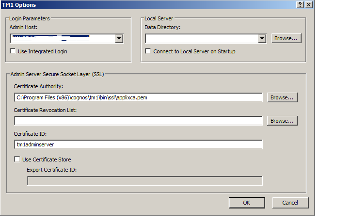

OK, I have been testing this all day and am still getting nowhere. I have mirrored my colleagues old TM1 settings and ensured the ini file has the correct admin host, I removed the data directory. Its as basic as it could be. I included it in the C:\ProgramData\Applix\TM1 folder along with the license file for the streaming profile.
I've simply installed TM1 perspectives, accepted the default location and specified a hostname when applicable.
Still not working. I don't know what else I can do here now.
This is my option window
I've blanked out the FQDN. If anyone has experience of application streaming with Citrix, would appreciate some assistance, because I think I've exhausted all the ways I can configure the perspectives options. I don't see how it needs to copied to a profile as it runs as a sandboxed application. My colleagues old profile didnt have any profiles included and I don't see any ini files on the Citrix profiles on the old server either. I am not convinced that I need to copy ini files to a server located profile which is never used on a streaming application.
Was really hoping this would be simple.
Matt
Re: Citrix and FQDN's
Posted: Mon Feb 10, 2014 4:42 pm
by Paul Segal
OK, one more thing to try: on the Citrix server (and not in the streaming app) can you run Excel and login to the server via Perspectives?
Posted: Mon Feb 10, 2014 4:56 pm
by MattC
That isn't possible. The Xenapp servers have Excel, but not the TM1 add in. Its a streamed app, so its never actually installed on the servers themselves.
If I go to the TM1 server and launch it, yes it works fine. Thats the only non Citrix test I can do when troubleshooting a streamed application.
Matt
Posted: Mon Feb 10, 2014 7:59 pm
by Paul Segal
And I think that is the problem. There's a few people using Citrix Desktop, others using published apps (like me), but I've not come across anybody using it as a streaming app. Something in there isn't right, and I would suspect the roaming profile isn't correct, or something along those lines.
