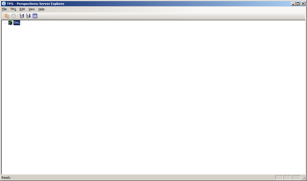

2. When opening Server Explorer, it doesn't have the correct configuration applied. The Admin Host is blank and the database path is wrong.
3. As per previous comment, I set the Admin Host to a NETBIOS name, SERVER1 for example and blanked the database path. I left the certificate path as default as I have this included in the package itself and the path it shows is correct. NO CONNECTION
4. Admin host set to a NETBIOS name. Database path set to FQDN\sharename on the TM1 server. NO CONNECTION

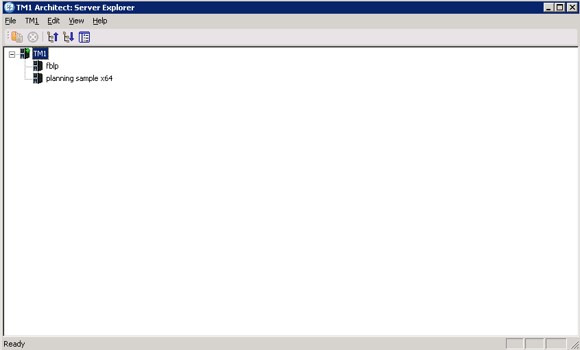

Attached are what I should see (and do when I RDP to the server directly) and what I don't when doing this via Citrix.
Not working
Not working
Not working
Not working.png (13.69 KiB) Viewed 19030 times
Working
Working
Working
Is there any log file that can give me an idea why the connection is not being established?
