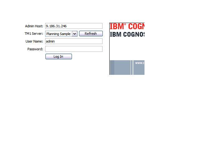

Yes, I can't see the server in Architect, I put the same host ip in Tm1web Admin Host window and Architect option window, then refresh available server, I can't see it at all
Architect option.JPG (43.59 KiB) Viewed 6526 times
No server.JPG (13.16 KiB) Viewed 6527 times

We found the problem. It was a DNS issue. While using the IP address in TM1 Web works it does not work in Architect. If you use the DNS name it works for both. I'm guessing the original problem for this post may have been related.
