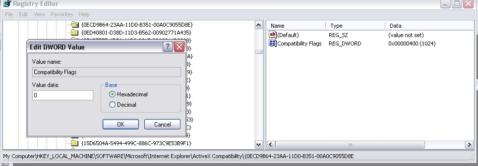

I had the same problem, you didnt need all four keys, I tried this on a Windows Server 2003 and on Win XP
The key i found on regedit, on Activex Compatibility was: {0ECD9B64-23AA-11D0-B351-00A0C9055D8E}
I modified the way I am describing to you on the attached picture and it is working fine. I never solved this problem removing or reinstalling Microsoft KB´s, I never found those.
I know this is probably not your answer, but that method worked for me.

I followed the instructions above and only found the key {0ECD9B64-23AA-11D0-B351-00A0C9055D8E} , after I changed the "Compatibility Flags" DWORD value to 0, my workflow works well now.
Thank you!

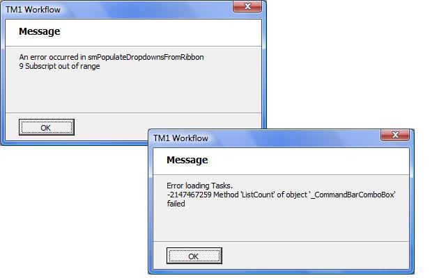

I change the compatibility flags for {0ECD9B64-23AA-11D0-B351-00A0C9055D8E} DWORD to 0 (it is the only key among four keys mentioned that have the compatibility flags)
Now I can click Admin button to open TM1 Workflow Administration Console and other buttons BUT the 'Load' button (despite the Load button working well from TM1 Web)
When I click the Load button in Excel, i get this message:
workflow error1.jpg (27.44 KiB) Viewed 9897 times

andre lie
Posts: 49
Joined: Thu Jun 05, 2008 9:54 am
Re: Compile Error in Hidden Module : frmtaskActions : TM1 Workfl
Post by andre lie »
I uninstall KB973346 but still get the same error message when i click the Load button
Rgds

andre lie wrote:I uninstall KB973346 but still get the same error message when i click the Load button
Rgds
pls try to uninstall windows update KB960715 ,too.

Yes I have uninstalled both : KB973346 and KB960715 with no success
