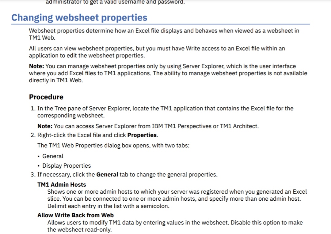

Don't know if this setting applies to admins or not and whether it would fit what about the "Allow Write Back from tm1web" setting per the screenshot attached. It might be set to disallow
- Screenshot_20250807_174835.jpg (225.54 KiB) Viewed 317081 times
