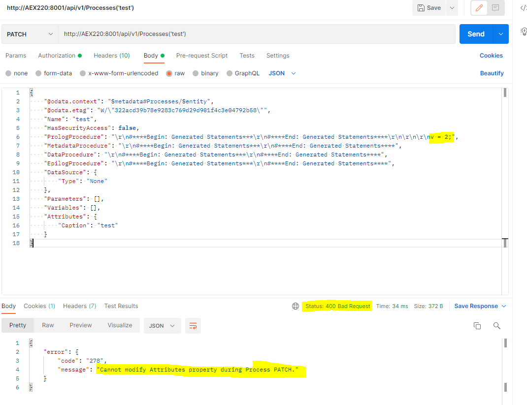

I change the v = 1 into v = 2 and I copy the whole lot into the JSON body for a PATCH statement, I get an error for "Bad request":
    "error": {
        "code": "278",
        "message": "Cannot modify Attributes property during Process PATCH."
(see below for a picture)

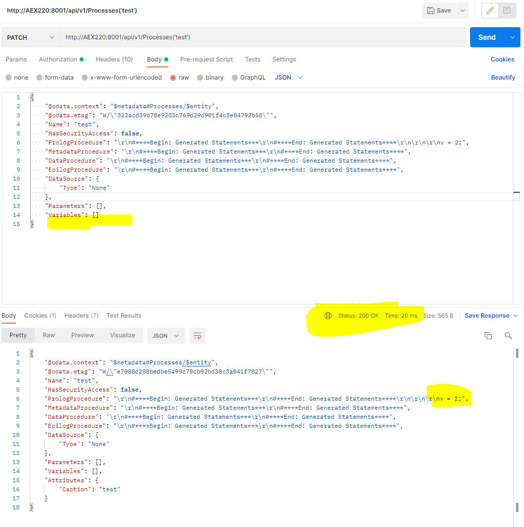

When I then manually delete the Attributes part in the JSON body and send the PATCH request again, it works:
    "@odata.context": "$metadata#Processes/$entity",
    "@odata.etag": "W/\"322acd39b78e9283c769d29d901f4c3e04792b58\"",
    "Name": "test",
    "HasSecurityAccess": false,
    "PrologProcedure": "\r\n#****Begin: Generated Statements***\r\n#****End: Generated Statements****\r\n\r\n\r\nv = 2;",
    "MetadataProcedure": "\r\n#****Begin: Generated Statements***\r\n#****End: Generated Statements****",
    "DataProcedure": "\r\n#****Begin: Generated Statements***\r\n#****End: Generated Statements****",
    "EpilogProcedure": "\r\n#****Begin: Generated Statements***\r\n#****End: Generated Statements****",
    "DataSource": {
        "Type": "None"
    "Parameters": [],
    "Variables": []

Did any of you encounter it before ? When I reverse engineer in tm1py, it does not seem to me that tm1py is doing anything with the body of the request. Certainly nothing with Attributes. Any help is greatly appreciated !

Marius Wirtz confirms that we should not do anything with the Attributes property when updating a process.
Either we strip it from the JSON body (result of a GET call), either we select the process properties we need (and exclude the Attributes property from that list).
