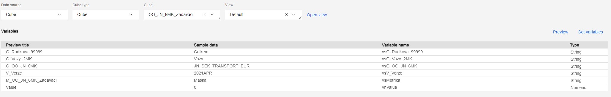

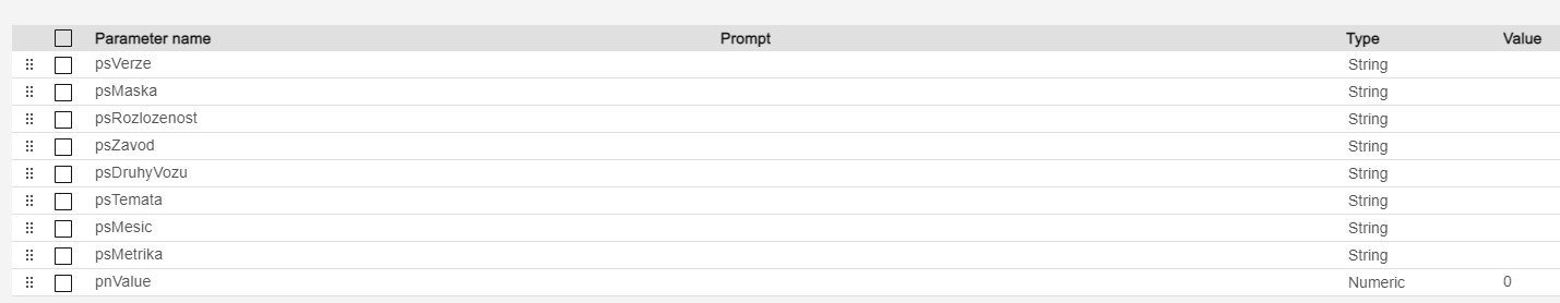

All the measure elements in TargetCube are numeric. The data source value from the first cube is set as numeric (viz pic1). The parameter in the second cube is set as numeric (viz pic1). I am using CellIncrementN. I have no idea why he would require string value?
Any help or advice?
Data source (First cube, first process):
Source 1 problem.jpg (72.61 KiB) Viewed 2072 times
Parameters in subprocess:

Post by vasek1192 »
Hi, vnValue is set as numeric in the datasource (viz first picture in original post). Some of the measure elements are string but they are filtered off from the sourceview.
