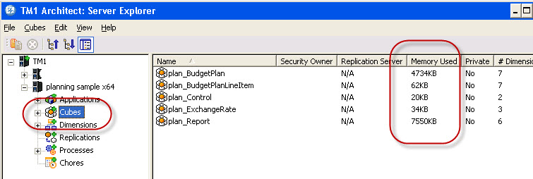

Re: TM1 Cube Size
In the Server Explorer, Click on the Cubes and then in the Properties Window it will tell you the size of the cubes.
See the attached screenshot

Re: TM1 Cube Size
As far as I am aware that is the size upon load. It doesn't tell you the actual cube size including cache and updates,
Jim.
Jim.

Re: TM1 Cube Size
We have found this list also includes cubes that are flagged to load on demand.
So they should not be consuming any RAM? Or at least very little?

Re: TM1 Cube Size
I think any detailed analysis on RAM, as you suggest, should be done using performance monitor. It will give you quite granular breakdown. ROT is that TM1, to date, does not give back any memory once it takes it from the OS.
