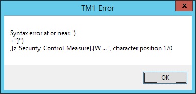

One behavior I have noticed is StrToMember function expected all string values
So I also tried
Filter( {TM1SUBSETALL([Project])}, [z_Security_Site].( [}Clients].[UserID],
StrToMember ("[Site].["+
MemberToStr([Project].[Primary Site] )
,[z_Security_Control_Measure].[Write_Flag])>0 )
- Error1

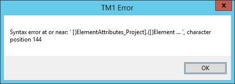

Filter( {TM1SUBSETALL([Project])}, [z_Security_Site].([}Clients].[UserID],
StrToMember("[Site].["+
MemberToStr( [}ElementAttributes_Project].([}ElementAttributes_Project].[Primary Site]) )
- Error3
- Error3.jpg (21.05 KiB) Viewed 22902 times
