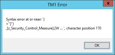

One behavior I have noticed is StrToMember function expected all string values
So I also tried
Filter( {TM1SUBSETALL([Project])}, [z_Security_Site].( [}Clients].[UserID],
StrToMember ("[Site].["+
MemberToStr([Project].[Primary Site] )
,[z_Security_Control_Measure].[Write_Flag])>0 )
Error1
Error1
MemberToStr([Project].CurrentMember.Properties("Primary Site") )

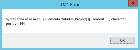

Filter( {TM1SUBSETALL([Project])}, [z_Security_Site].([}Clients].[UserID],
StrToMember("[Site].["+
MemberToStr( [}ElementAttributes_Project].([}ElementAttributes_Project].[Primary Site]) )
Error3
Error3
MemberToStr( [}ElementAttributes_Project].([Project].CurrentMember, [}ElementAttributes_Project].[Primary Site]) )
Error4
Error4
