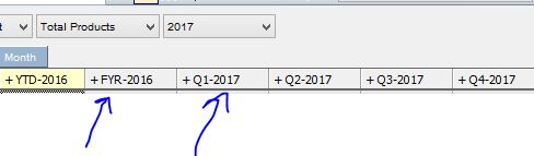

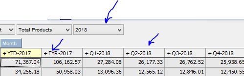

Dear all, Appreciated for your aid.
Please this what I ask for.
- 2.JPG (24.11 KiB) Viewed 12498 times
- 1.JPG (18.36 KiB) Viewed 12498 times
