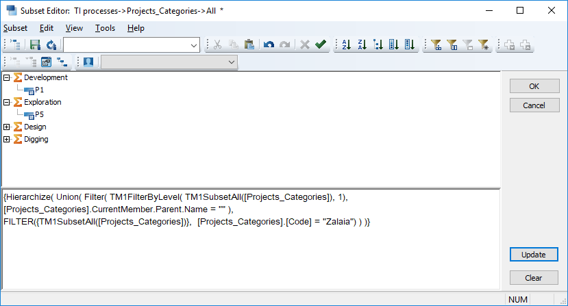

I would use:
{Hierarchize( Union( Filter( TM1FilterByLevel( TM1SubsetAll([Projects_Categories]), 1), [Projects_Categories].CurrentMember.Parent.Name = "" ),
FILTER({TM1SubsetAll([Projects_Categories])},  [Projects_Categories].[Code] = [factory].[Code]) ) )}
Posts: 3244
Re: Dynamic Filters in Cube Viewer
The code attribute should only be filled in at level 0.
Attached a picture.

Wim Gielis wrote: Sat Mar 03, 2018 10:11 pm The code attribute should only be filled in at level 0.
Attached a picture.
Ohhhh my god, It's worked successfully. Actually I don't find any words present my feelings. Really Appreciated Sir ..
