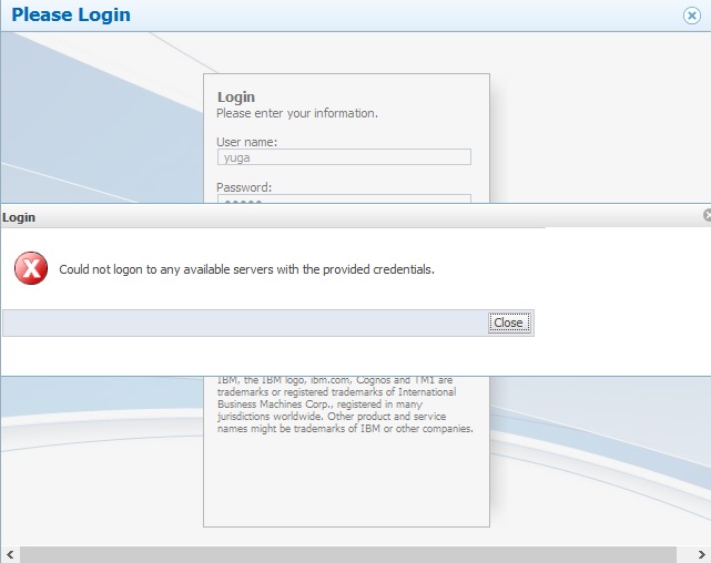

I have installed the TM1 10.2.2 version ( Windows 10 OS) and installed the SSL certificates also. The architect and perspective is working fine but when I open the TM1 performance modeler , it is throwing errors. For the default server, Planning sample as " Unable to connect to the Planning service" and for another server as "could not login to any available Servers with the provided credentials. Could you please tell me what is the issue, even when the architect , perspective is working fine with the same login. Attached are the screenshots.

- 2.jpg (48.36 KiB) Viewed 10891 times
- 1.png (125.62 KiB) Viewed 10891 times

Tried the below options but it is not working. When i login with planning Sample server, it allows login and i can see the server but when click ok then it throws the error " Unable to connect to the Planning service"

i have tried the given option but still couldn't succeed. I got the attached warning error and I had updated the tm1s.cfg file also with below options. But Still it throws the error as " unable to connect to the planning service". I tried to connect to another server also but it throws the same error as " unable to connect to the planning service"
