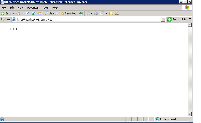

Hi, I really got stuck TM1 web. Could you please help... ?
TM1 Server 10.2.2 64 bit was installed into Windows Server 2003 and TM1 Client 10.2.2 was installed into separate client PC (Windows 7).
And started "TM1 Application Server", "TM1 Admin Server", "TM1 Server instances" in Windows Server. (I did not change TM1 application server component properties. ).
http://localhost:9510/ or http://tm1_servername:9510/ does not work on TM1 server and client PC. It shows 5 squares.
ERROR LOG: I can see following errors. At C:\Program Files\ibm\cognos\tm1_64\logs\stderr_20140604.log
Jun 04, 2014 7:55:57 PM org.apache.catalina.core.AprLifecycleListener init
INFO: The APR based Apache Tomcat Native library which allows optimal performance in production environments was not found on the java.library.pat
However, file size of tm1web.log (C:\Program Files\ibm\cognos\tm1_64\webapps\tm1web\WEB-INF\logs) is 0.
It seems tomcat is not working on the TM1 server.
Do you have any idea to solve this issue?
P.S I could confirm that tomcat is running on task bar.
- tm1 web screen
- tm1.jpg (47.88 KiB) Viewed 18587 times

I got following error at stderr_yyyymmdd.log
Jun 12, 2014 9:13:28 PM org.apache.catalina.core.StandardService start
SEVERE: Failed to start connector [Connector[HTTP/1.1-9510]]
LifecycleException: service.getName(): "Catalina"; Protocol handler start failed: java.net.BindException: Address already in use: JVM_Bind <null>:9510
Any idea?
Any idea?

9510 port was used for another process, so I configured with port 9511 and stop-> start TM1 Application Server and File -> Save and tm1web worked now with http://localhost:9511/tm1web
Thank you very much everyone!!.
