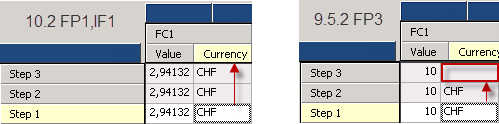

  • A rule shall carry forward a numeric value as well as a string value along a dimension of three elements ("Step 1", "Step 2", "Step 3"). In each step, there should take place some magic logics, but the logics are not causing the problem, so just forget about.
  • Numeric and string value is entered in cube in Step 1 (see screenshots below). The rule shall just carry forward both values from Step 1 to Step 2, and from Step 2 to Step 3. That's it (at least in the minimal example outlining my problem).
As you can see in the screenshots below, the carry-forward works in 10.2, but does not work in 9.5.2: While the values are still carried forward to Step 2, they are not carried forward to Step 3.
Different behaviour in 10.2 and 9.5.2 for string values

Update: just noticed in 9.5.2 FP3, that strings are carried forward as expected if I'm using ONLY =S: statements:
#Carry forward from Step 1 to Step 2
['Step 2'] =S: DB('test_cube',!Dim1,!Dim2,!Dim3,!Dim4,!Dim5,!Dim6,'Step 1',!MeasureDim);
#Carry forward from Step 2 to Step 3
['Step 3'] =S: DB('test_cube',!Dim1,!Dim2,!Dim3,!Dim4,!Dim5,!Dim6,'Step 2',!MeasureDim);
Leads to the expected result for the string element:
Works fine if only =S: statements used
However, once adding any "=N:" statement will cause the string values fail to carry forward. May be this is a helpful information for anyone.
