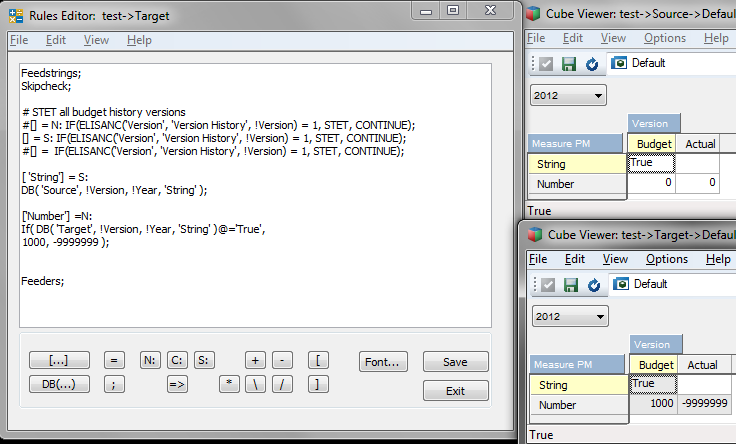

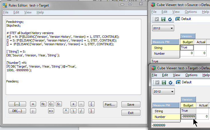

Here are the images and rules. There are two identical cubes: Source and Target. The dimensions are Version, Year and Measure.
In the Version dim, Actual version is a child of "Version History" parent while Budget is not. In the Measure dim, the elements are String and Number. Only Target cube has rules. It pulls the String value from Source cube over to its own String measure. Then, if the calculated String value is "True", Number value will return 1000, else it will be -9999999.
Case A - Using [] = S: and []
Result: Number is calculated to be -999999 even though String (calculated) is "True" i.e. failed. STET is working in Actual version.
Case A_S and All_Fail.png (48.65 KiB) Viewed 18053 times
Case B - Using [] = S: ONNLY
Result: Number is calculated as 1000 as String (calculated) is "True" i.e. correct. STET for string is working in Actual version.
Case B_S only.png (48.67 KiB) Viewed 18053 times
Case C: [] = N: only
Result: Number = -9999999 i.e. failed.
Case D: [] = N: and [] = S:
Case E: [] only without qualifier
Case F: No STET at all
Result: Number = 1000 i.e. correct.
tm1s.cfg:
AllowSeparateNandCRules=T
I have also tested using AllowSeparateNandCRules=F, the results are still the same.
Hope this explains my observation. Let me know if you need more info.
Re: Best option for not calculating other versions in cube
Yuck, Agreed this is a bug.
I'm wondering if t might correct itself if you fed your string cell from source?
Cheers,
harrytm1
Posts: 226
Joined: Thu Apr 02, 2009 2:51 pm
Version: Latest version
Excel Version: 2003 to 2019
Post by harrytm1 »
Sadly, feeding it does not help. I have tried in the actual model.
Please also note that TI will also fail to recognise the calculated string value even if it's fed.
Serious bug.
