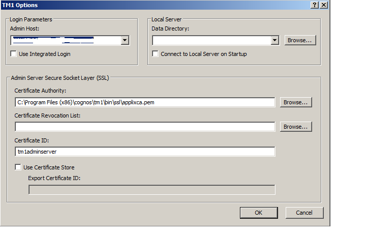

OK, I have been testing this all day and am still getting nowhere. I have mirrored my colleagues old TM1 settings and ensured the ini file has the correct admin host, I removed the data directory. Its as basic as it could be. I included it in the C:\ProgramData\Applix\TM1 folder along with the license file for the streaming profile.
I've simply installed TM1 perspectives, accepted the default location and specified a hostname when applicable.
Still not working. I don't know what else I can do here now.
This is my option window
I've blanked out the FQDN. If anyone has experience of application streaming with Citrix, would appreciate some assistance, because I think I've exhausted all the ways I can configure the perspectives options. I don't see how it needs to copied to a profile as it runs as a sandboxed application. My colleagues old profile didnt have any profiles included and I don't see any ini files on the Citrix profiles on the old server either. I am not convinced that I need to copy ini files to a server located profile which is never used on a streaming application.
Was really hoping this would be simple.
