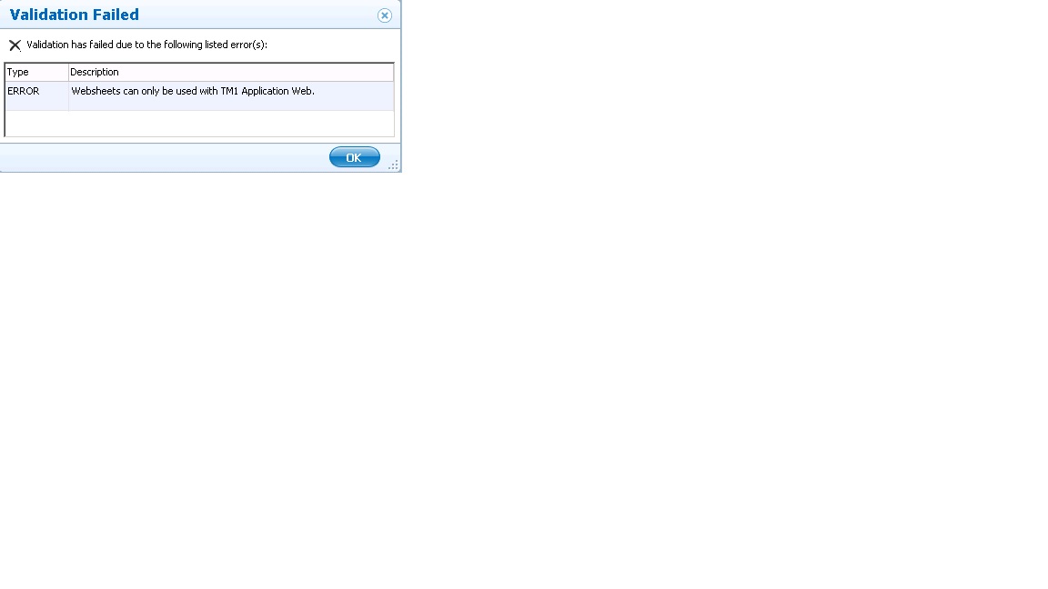

Thanks Stephen I did not know
I tried, unfortunately, it seems it's not usable by Cognos express Planner 10.1 only with TM1...
- error.jpg (34.29 KiB) Viewed 4804 times

Re: Contributor/Planner Layout
I would be surprised if websheets couldn't be used in CX 10.1
I would rather guess that you enabled this application also for Cognos Insight but websheets are not allowed to be used in Insight.
You can definitely use websheets in CX 10.1 Planner applications!Jonsulli wrote:Thanks Stephen I did not know
What you can't do in either TM1 or CX is use Cognos Insight as a distributed or connected client for any application that uses websheets. Insight supports views only.
You were absolutely right mvaspal and Lostaram !!!
It works perfectly now !!!
Thanks a lot
