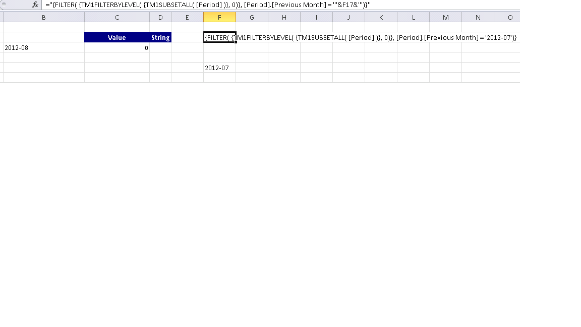

So you tried {FILTER( {TM1SUBSETALL( [Customer] )},[Customer].[Group]= '"&F16&"')} ?
see simple example below

Worked. Sorry for the confusion.

' " & Cell Reference &" ' is a trick to use ;)
