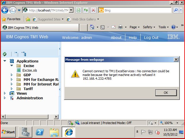

we encountered an error when we try to open an excel template on application tab
error detais : cannot connect to TM1 Excel Service : no connection could be made because the target machine actively refuse it server:4785
TM1web.log
ERROR Applix.TM1.Web.WebControls.TM1WebUtils - <Cannot Connect to TM1 ExcelService : > not Localized
We already change the Login to Administrator with administrator rights. And also I put administrator security on the TM1Web folder and TM1WebEx folder
I can browse the cubes but I can't open Excel Template
TM1web.log

Yes, I stop and restart excel service using the administrator account of the server /client workstation.kindly see kindly see attach file
- error excel tm1web app.JPG (69.66 KiB) Viewed 14698 times

I've just had a similar problem, I was using a local user which was added to the local admin group on a domain connected server. Everything worked apart from displaying excel reports through tm1web. I was getting the same error as screenshot'd above
I solved the problem by running all the IBM processes as a domain user that was added to the local admin group...
The closest I could get to a service account, but as the user's password changes, I will need to update the logon information that the processes are running under. Not ideal, but will do until I can get a domain service account setup
