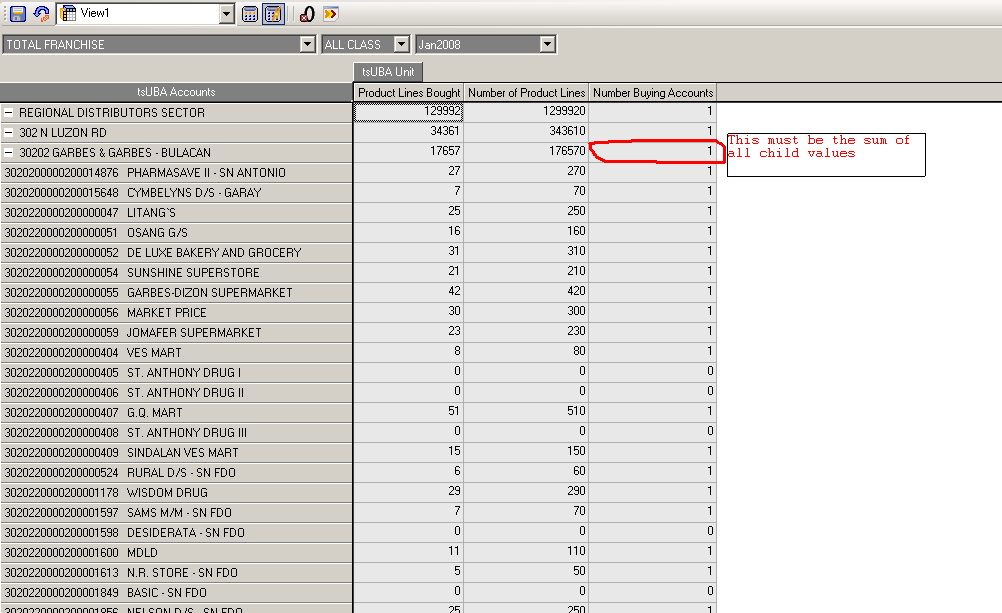

Im experiencing a problem on summing up the child values generated by the rule i made. See my attached screenshot.
This is my current rule:
SKIPCHECK;
['Number Buying Accounts']=IF(ELLEV('tsUBA Accounts',!tsUBA Accounts)=0, IF(['Product Lines Bought']=0,STET,1),1);
What do i need to do in order be able to sum up the child values?
Your help is greatly appreciated.

I'm not a rule expert (so maybe i'm talking ****) but
- you can define that the rule only points on N: Elements
- or you exclude the Consolidation with stet from the rule
depends on what you need

You have two problems
1 Write your rule so it applies to the N level only
['Number Buying Accounts']= N:
2 You will need to feed the rule (or remove the skipcheck not recommended).
Feeders;
['Product Lines Bought']=>['Number Buying Accounts'];
If I'm understanding what your trying to do (count the number of prodict sales). I think the last ",1);" needs to be 0); or you will be conting all 0 level accounts irrespective of Product Lines Boght. If your rule is correct as written with the last 1 in place, then I think your rule is "impossible" to feed since the last 1 is not dependant on any other value in the system.
HTH don't have tme for more detail...

I think you need something like the following:
SKIPCHECK;
['Number Buying Accounts']=N:
IF( ELLEV('tsUBA Accounts',!tsUBA Accounts)=0 & ['Product Lines Bought']>0
1
0
Feeders ;
['Product Lines Bought'] => ['Number Buying Accounts'] ;
Consolidation in the tsUBA Accounts dimension which I presume has one entry per buying account at the base level, will do the rest. You just need to make the rule generate a 1 for each buying account, at the base level.
