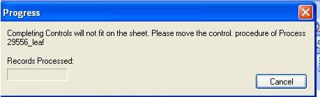

Anyhow, the TI process seems to be running successfully but I get this strange error message while it is processing...
"Completing controls will not fit on the sheet. Please move the control. procedure of process ..."
Another dialog box opens that says...
Completing error %'s
Then the TI process completes and says "Process has completed successfully"
Has anyone ever encountered these error messages?

I've always assumed that the only thing that those messages mean is that there is a bug in TM1 such that it isn't passing the correct arguments to the function that displays the TI Process progress dialog box. I don't consider them to be actually telling me about errors in my TIs. (What? Errors in my TIs? Surely not!
I've seen the 'error %s' one fairly frequently, and the one about controls only more recently, but they are only showing up when I would expect there to be a message box showing me the progress of a TI process. If you take the 'Completing' from the start of the message and the the 'procedure of process' from the end, then take your pick of Prolog, Metadata, Data or Epilog to go between them and add a TI process name to the end, then they start to make sense.
Unfortunately the only idea I've got to get round the dubious messages is to get the users to run the process via TM1 Web, as they won't see the intermediate messages, only the one saying Process Completed Successfully!

Apparently this error has been identified as a bug in version 9.5.x in the TI interface and has been fixed in the TM1 10.1 version.
See this URL for details: http://www-01.ibm.com/support/docview.w ... wg1PM32962

I have this issue with my action button attached to Tis in 9.4MR1FP3 as well.Apparently this error has been identified as a bug in version 9.5.x in the TI interface and has been fixed in the TM1 10.1 version.
HTH
