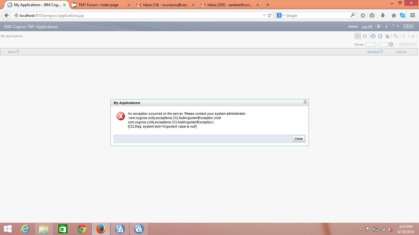

Problem 1: I am not able to launch the Application Web . Error as Follows.
An exception occurred on the server. Please contact your system administrator. :com.cognos.ccl4j.exceptions.CCLNullArgumentException (root com.cognos.ccl4j.exceptions.CCLNullArgumentException):
[CCLMsg: system text='Argument value is null']

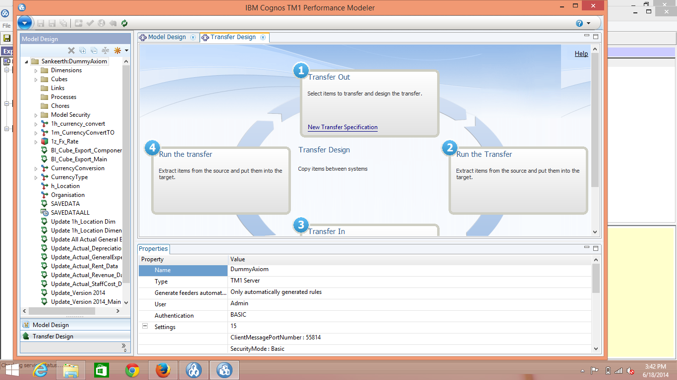

Problem 2: The Same Problem Continues with in PM . I am not able to launch the Application DesignPannel from PM 10.2.
There are only Model Design Panel and Transfer Design Panel. No Application Design Panel.
Kindly help in resolving the same.
